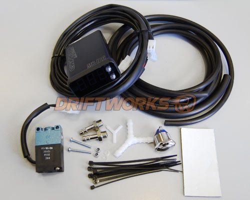

Hey, so do you guys have rubber gromets in the the solenoid hole where you screw in the nipples? Because I don't, and I think it logically makes sense for the boost creep up and be unstable if there are leaks there.

....do you guys have rubber gromets in the the solenoid hole where you screw in the nipples? Because I don't, and I think it logically makes sense for the boost creep up and be unstable if there are leaks there.....
I don't understand what you are referring to. It would be helpful if you would post up a pic. Thanks!
I've attached a pic here. It's not my boost control solenoid btw.
See how you have to screw in the nipple? And I think there is a rubber o-ring inside the hole in the picture to keep the boost from leaking? See I don't have any o-rings on both holes so it's just metal-to-metal contact.

Hmmm. Is that Hondata solenoid an integral part of your boost control circuit along with the EBC? You are full of surprises aren't you! You have been holding out on us.
No, you do not need an external gate. You have enough gizmos and doodads on there as it is.
We are going have to start you back at square one. You don't need a fancy EBC or that boost control solenoid to control boost on your setup. Do you have rudimentary hand tools and the basic wrenching skills? Are you willing to skin your knuckles?

Originally Posted by stevolution84
I've attached a pic here. It's not my boost control solenoid btw......
Wait a minute! Now, you've got me confused again. You've attached a pic of a Hondata BCS, and it is labeled as being such in the pic, but you then go on to state that it is not your BCS
Wait a minute! Now, you've got me confused again. You've attached a pic of a Hondata BCS, and it is labeled as being such in the pic, then you go on to state that it is not your BCS
Do you or don't you have such a boost control device installed and connected to the boost control circuitry on your Evo. I gots to know!
Hey, this is my gizzmo ms-ibc set. The EBC came with the BCS.
The hondata pic was just to show you what I meant by the o-ring and the nipple I was thinking without the o-rings inserted, at boost there will be leaks which will cause the internal wastegate to close = boost instability.
When I had stock exhaust system with ECU controlled boost solenoid, the boost goes up to about 19 then tapers down to about 16~17 so I think that means the internal wastegate is fine?
