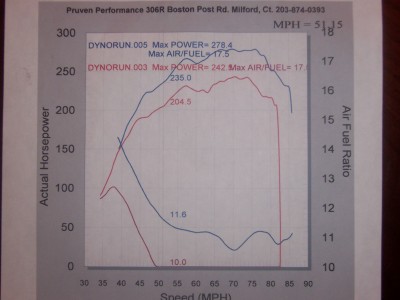

Yes, as you described regarding timing retard sounds similar to what is happening. But I still wonder what the popping noise I heard is. I was thinking it may have been audible detonation, but it was more of a pop, than a sound of marbles as some may have described.
Btw, when I got tuned by Al with the Dynoflash, he tuned my A/F pretty conservatively. Here is my dynosheet and A/F.
Im wondering of a combination of bad gas, cold weather, and 19/20 psi @ redline is causing my headaches.
Ken

From your dyno charts.. you are retarding timing.... a perfectly tuned curve is even (almost smooth) and does not have the dips... those dips are caused by the ECU retarding timing when it detects knock.... look at mine.. and from what you are describing of bogging at 5k and at 7k.. its consistent with the chart u put up... better tell your tuner to redo it... get him to do a smooth curve... if not, you keep experiencing the same thing...
