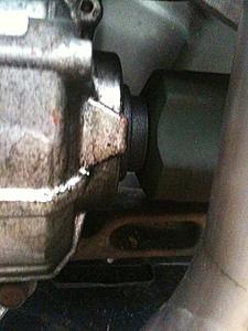

This morning I've noticed there were some leaks from the right size of the rear diff.
I'm just after what you guys think it's wrong and get a better idea what the problem might be before taking it into a mechanic.
I've attached the pictures.
Circled 1 = saw couple of drips
Circled 2 = couple of drips from circle 1 originated from circle 2
Thanks in advance!

Looks like a seal is gone.

looks like a seal gone .
Did you get the ayc oil bath changed in the diff lately ? if it was overfilled it can come out through the breather on top and will end up down there also
mitsi part no for the seal MD755526
