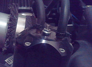

I imagine that's too much preload. Here's how mine looks.

Thanks raptord.. I will mimic what you have and install and see what happens.. I don't think much will change. IDK just don't get it.
