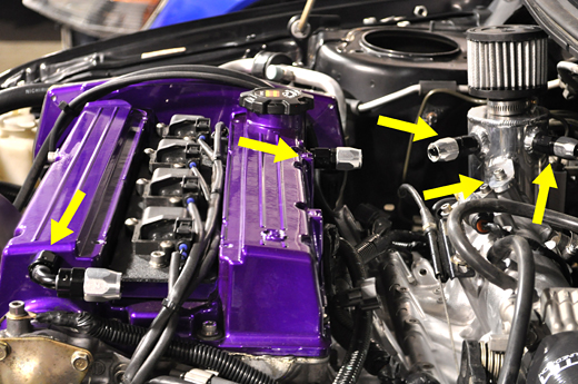

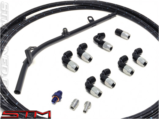

Bringing this back, I have a stock turbo setup for now 280whp/300wtq mustang dyno. I am going to be running a GT3076 shooting for 450whp with kelford 272s and I have a couple catch can setup questions.
Is anyone running the vented dipstick tube with -6an fitting? or the -6an balance shaft inspection hole fitting along with venting the valve cover all in the same can? I am going to run a catch can setup but before I buy one I didnt know if anyone had any input in regards to venting the block as well as the valve cover. Or if venting the two valve cover fittings is all you need. Thanks!
sorry for picture size =/ Is this sort of the setup you are running Binky?

Thats a very good question, is venting the block required? and should it also be connected to the catch can? Like at the bottom of the can, that way all the oil drains back to the pan. Both these guys did it on their blocks
https://www.evolutionm.net/forums/al...374-build.html
http://www.evo123.net/showthread.php?t=927&page=4
Old Sep 13, 2013 | 03:18 PM
  #59
03evolution8's Avatar
Joined: Dec 2012
Posts: 4
From: Vermont
this catch can setup would do everything. my setup probably doesnt need this much venting but thought it was cool and didnt know if anyone had any experience with the vented dipstick tube. the fitting on the bottom lets it drain back into the dipstick straight down.
not trying to say a setup is better than another, was more looking to hear what some people had to say about block venting

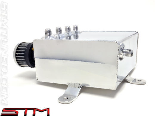

The bottom fitting is designed to drain to the ground.
I know there are kits out there that allow it to drain back into the engine, but on any car that's running E85, you're getting water and other stuff in your oil that you don't want to have drain into your engine.
If you have any questions about the kit, feel free to PM or call us.
