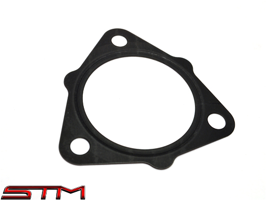

Are both of these the same. I have oil seeping from both plates so want to order new gaskets.

They're different. The gasket on the intake side has a slightly different shape and only 2 bumps.
Use part # 1865A033

Perfect that is what I thought. Thank you!!!
