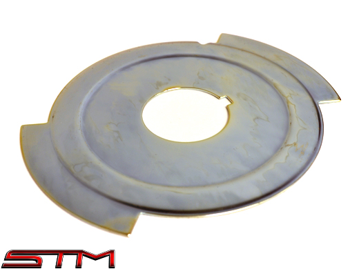

I'm having the same problem right now on a new motor I just built, but I think I know what the problem is though. It looks like your belt is hitting the crank trigger plate (reluctor, thin piece of metal) whatever you want to call it. I believe the problem to be the timing tensioner arm itself. As the auto tensioner rides on the tensioner arm it forms a dimple in the bottom of the arm over time (mine has one @ 40k miles). If its not dead center its going to naturally move the belt in. Now I think these blue gates belts (same one I have) are a hair wider than the OEM belts so this amplifys the problem more. From the factory these belts sit very close to the crank trigger plate, once these two other problems are thrown into it, I believe it is causing the belt to walk into the crank trigger plate. I can actually turn my motor over slowly and see the belt hit the trigger plate and from your picture that looks like what's happening to you. I'll update as soon as my new arm comes in at the dealer.

To add to this if you take a look at the tensioner pulley it guides the timing belt with the lip on the edge of it. If the arm isn't riding center on the auto tensioner like I said before its going to move the belt in the direction it wants to go and push the belt into the trigger. Hope this helps us both!!

Well sorry you are having the same issue but kinda happy I am not alone. I got a new plate today so going to see if that does anything here is a better video of the noise you can really hear it. This is about 10 mins of the car at idle so nice and warm
