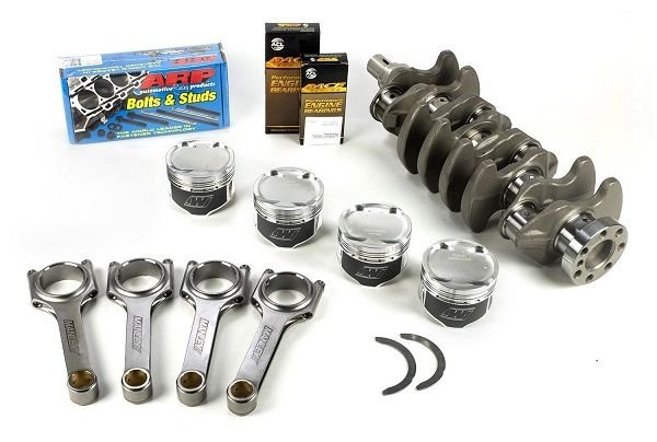

Hey guys I just wanted to get some advice on these MAP shortblocks for my EVO 8. Unfortunately, I bought my Evo with a bad engine. I thought I may as well replace the current stock 2.0 with a reinforced shortblock so I can perform upgrades later down the line without having to worry about the bottom end. Ive been doing some research and saw that the MAP shortblocks seems to be a good route. My question is, has anyone had experience with these?

Hi everybody
I'm also looking for the MAP STAGE 1 and need some Input about this.
My Option would be:
- OEM Crankshaft
- Manley 150mm H-Beam
- Wiseco Standard Forged / 85.5mm Bore (.020" Over)

power goals?

Power Goals are around 480 - 500 hp and 550 - 600 torque with 98 octane

I would say that the good choice would be BW I beam rods (or H beams if on budget) and Mahle racing pistons. Those will be OE quiet and work at that power level. Everything is available in the UK. As a matter of fact I built an engine using BW H beams and Mahle racing pistons, running 470 hp / 550 Nm tq

470 hp & 550 Nm tq would be also okey for me.
But i need to know if somebody made experience with the Map Stage 1 Set up in the thread
