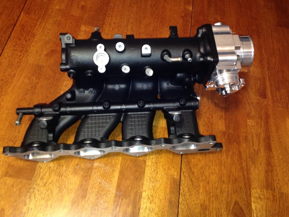

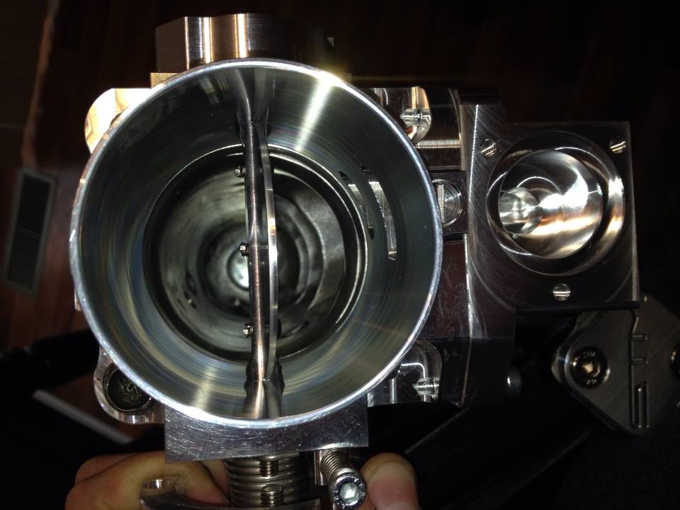

curtbrown ported intake with 70mm flange and buy the 70mm s90 fits and looks great ! His work is top notch, and he is a great guy .
Attached Thumbnails S90 throttle body question-1607035_10151981683469195_1506593400_n.jpg   S90 throttle body question-1235393_10151981683474195_1469238861_n.jpg
