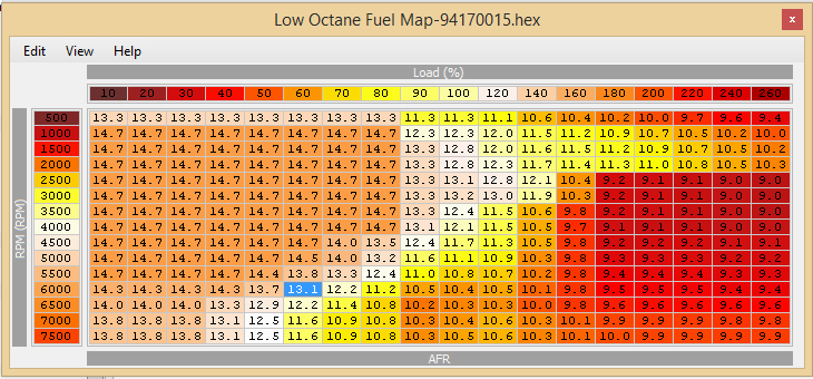

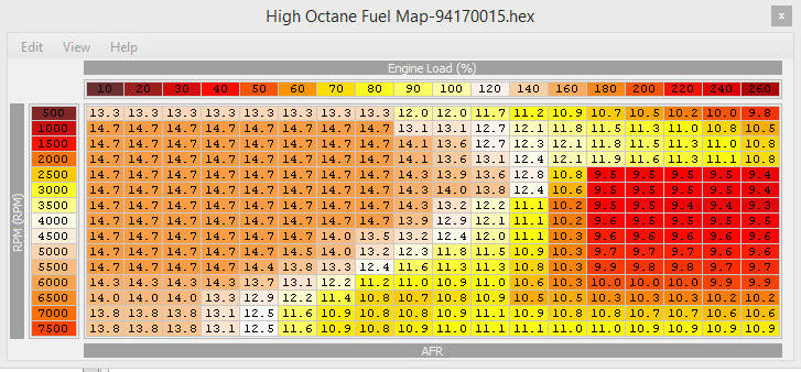

Finally got my Openport 1.3U in the mail today.. Figured out why I'm running so rich. See attachments.
Attached Thumbnails Instant Boost Loss-high-octane.png   Instant Boost Loss-low-octane.png
