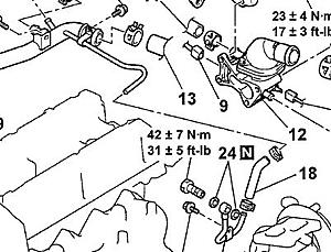

Based on the spray pattern I don't think it's dripping onto the temp sensor. There's dry coolant on the t-stat housing above it where it shouldn't be getting sprayed by a leak at the t-stat housing to soft line connection. I would check the upper connection of hose #18 and where it mates to the hard line. Also check the inside of the bend on the hard line for coolant spray.

So I didn't find any tears or obvious marks but I did happen to notice that I was able to slide that rubber hose onto the hard line on the turbo back about an inch. The spring clamp was holding it down and there is a bead/ lip on the end of the hard lines so its not like it was about to come off but its had worked its way down a little. I slid it upward as much as I could hoping that'll resolve the seal if there is an issue with it
I will take a look after my commute to work tomorrow and see if my line shimmying resolved the issue. If the spray pattern looks different then at least I know the culprit and Ill just need a new hose and clamps. Until then, I'll keep my fingers crossed.

I'm feeling confident that you were spot on. Its still spraying but if I yank on that connection it moves around a little so I think the hose has deteriorated over time. There are no rips or anything but it doesnt seem to make a proper seal anymore. I just ordered a new hose and new spring clamps and will swap it when they arrive and hope that was my issue.

I was able to open the car up on my ride home from work tonight and I am happy to say that so far so good!
Thanks to all who chimed in; I appreciate all of your help.
I will be at Devens on Saturday so I will report back after to confirm that its still completely dry.
FWIW I inspected my coolant hose and I'm still not seeing any pinholes in it. My thought is that either the rubber over time deteriorated, became a little harder and no longer made a tight seal to the hard line. My other thought is that my spring clamps wore out over time after repeated removal. Worm clamps in lieu of the spring clamps is probably a good idea but I ended up picking up two new spring clamps when I purchased the hose.
