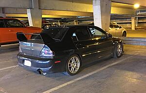

Totally forgot about this issue, I suppose I better come back and update.
So the clicking was occurring on my summer tire set-up:
Enkei RPF1s 18x9.5 after I got new brake pads/rotors installed on my old suspension set-up (stock shocks w/ tein coils).
I then changed to my winter set-up:
Stock Evo 9 Enkei's with Blizzaks on old suspension set-up and the clicking went away.
Then I got a new suspension set-up: D2 Street Coilovers because the old set-up was shot to hell. Also got it aligned of course.
Still no clicking.
Just recently swapped to my summer set-up again with the new suspension and NO CLICKING PRESENT! Hooray!
I don't really have a clue what was causing it, maybe something to do with the worn out old suspension on a tighter fitting wheel.
New set-up:
