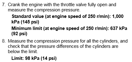

The spec for a IX is minimum of 92psi with a maximum difference between cylinders of 14psi
You're well within spec

It says the standard value is 145 PSI....if it's 92 it's toast.
You want it as good as possible which means close to 145.
Have you checked the cam timing?
You haven't said what the problem was for you to check the compression in the first place.
Looking at the sparkplugs usually tells you more than what the compression tester does.
