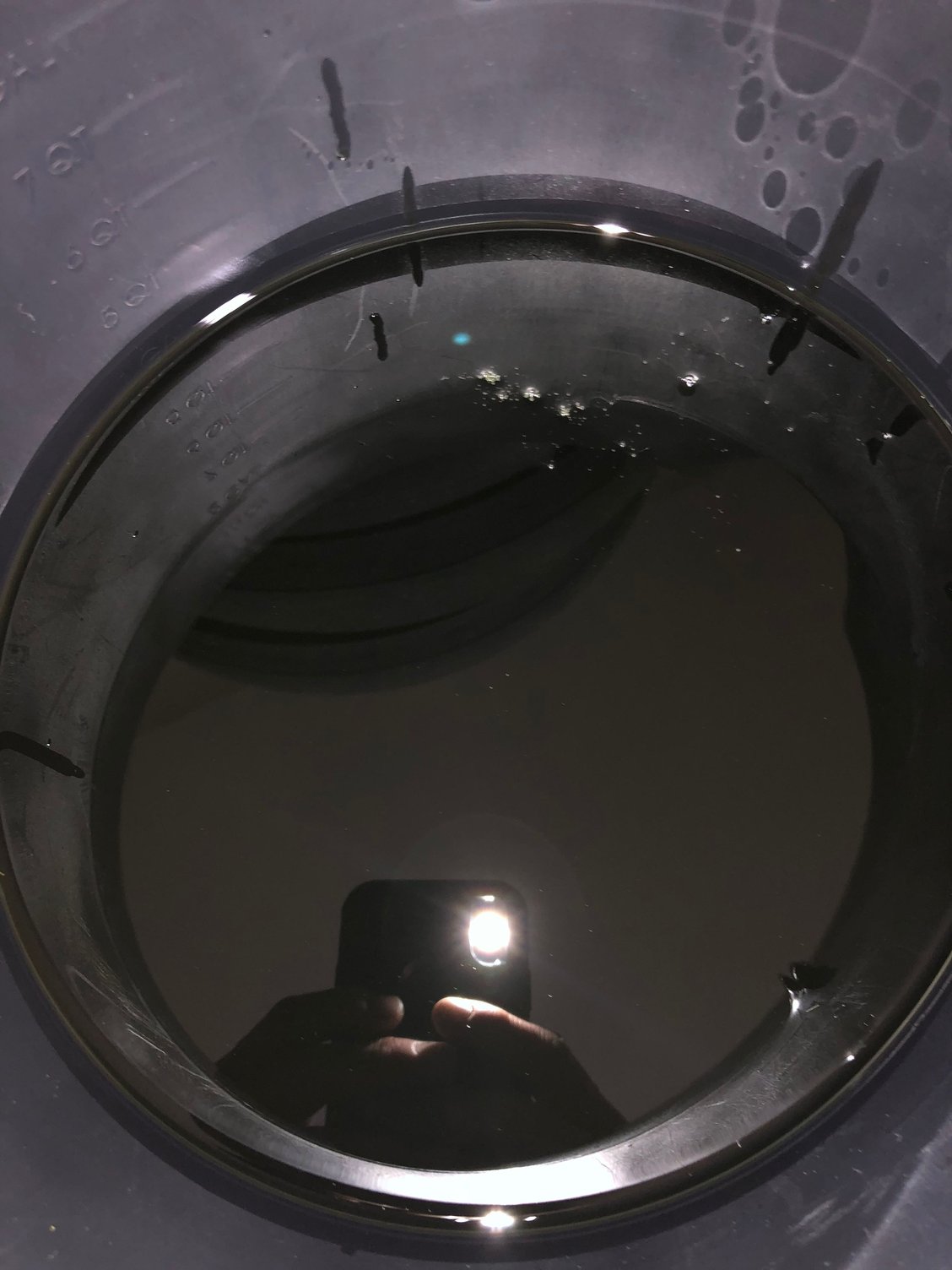

Heres a pic of the oil after letting it settle today. I suppose it’s fine

Pour that into another container. Check at bottom if there are any coolant. Oil will float on coolant so if you have any in there, you'll find it at the bottom.

you're right, coolant leaking into oil forms a milkshake color mix while oil leaking into coolant will float (probably not enough oil to form the milkshake mixture).
That oil in pan looks normal to me.

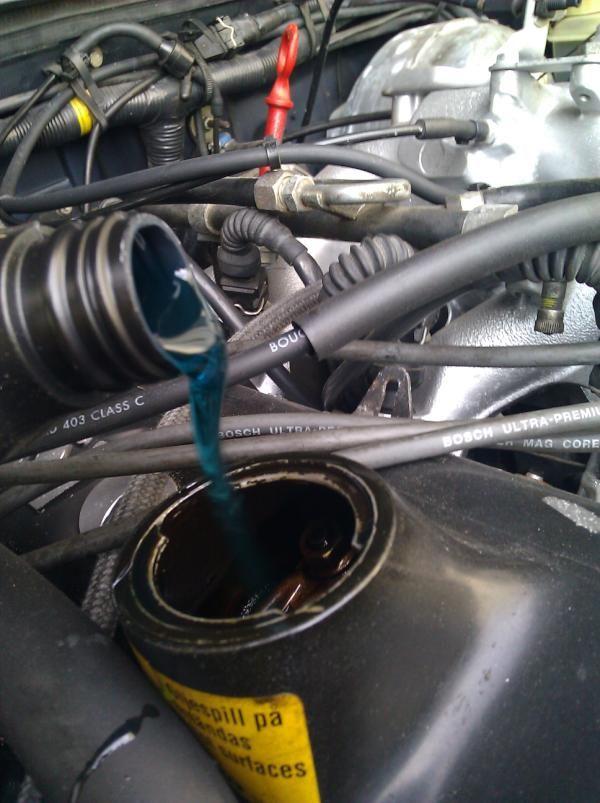

If it's VR-1 synthetic, the oil itself is blue. I always joke that it's made from Smurfs LOL
Exactly which is also making me wonder why it looks green lol
