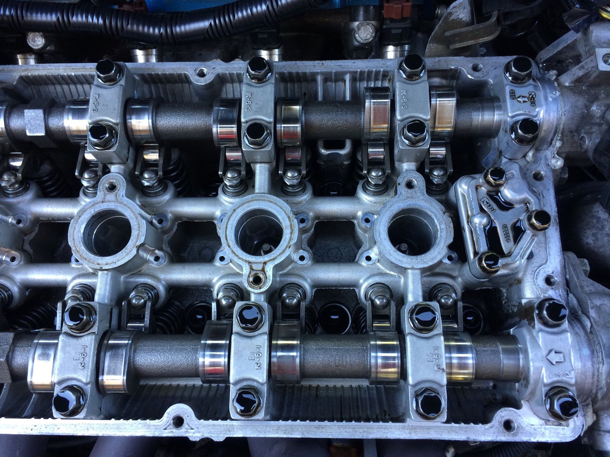

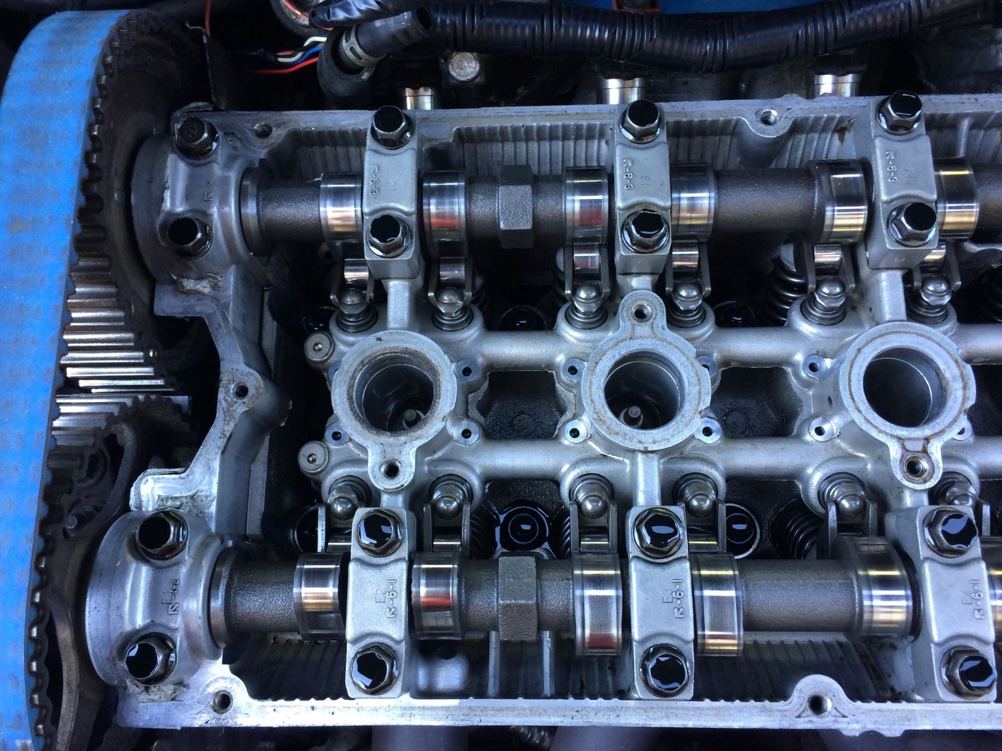

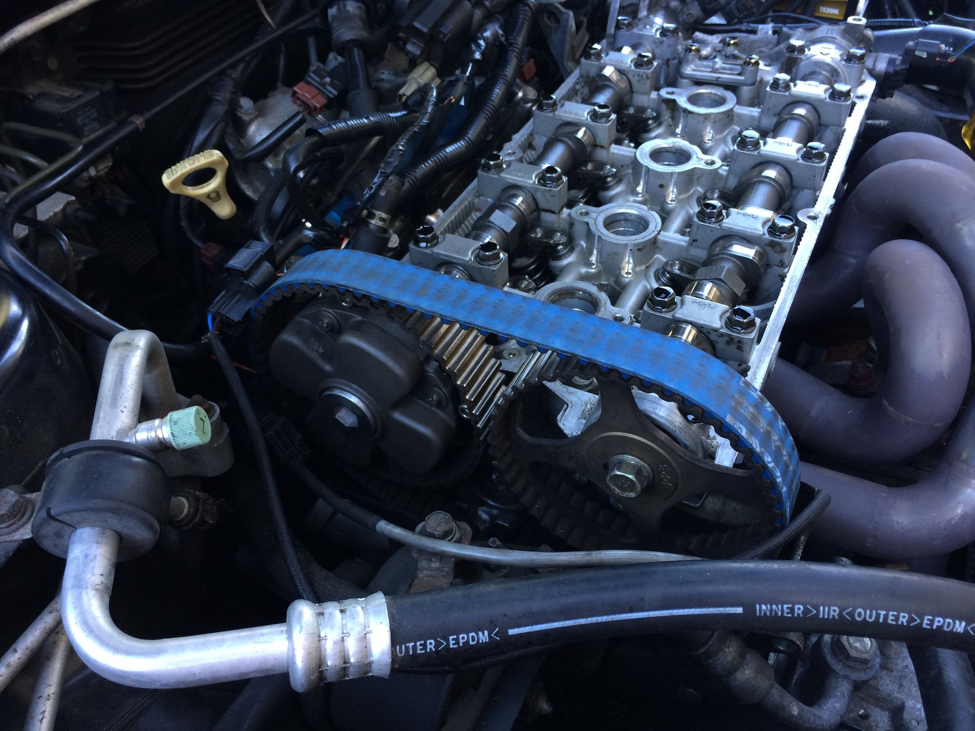

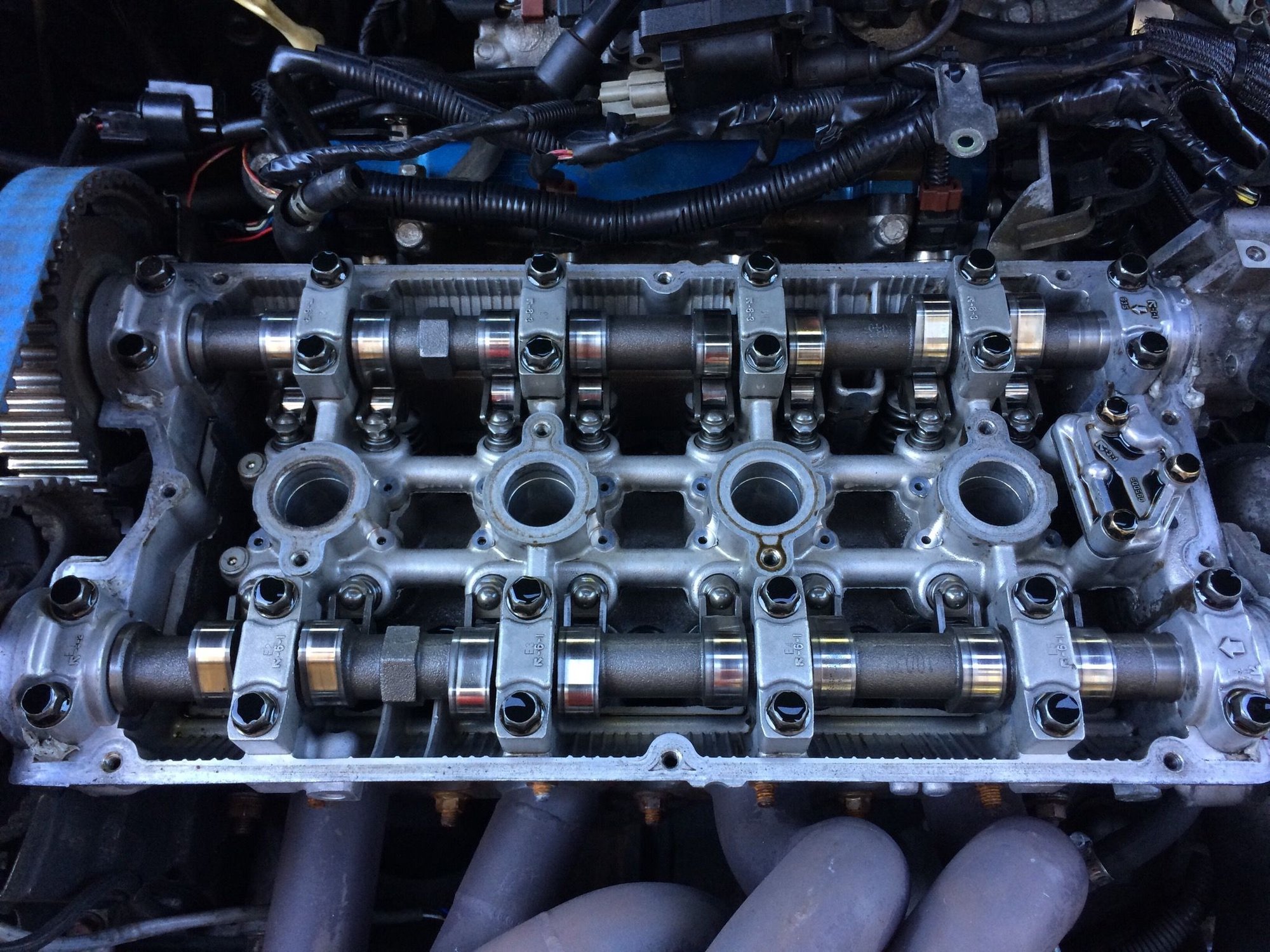

Check your cam timing marks. Your photo looks like #3 looks like it is at end of exhaust stroke and at start of intake stroke. Cam lobes looks fine to me (exhaust 3/intake 2, exhaust 4/intake 1, exhast 2/intake 3, and exhaust 1/intake 4 should have lobes in same positions). Post more pictures and maybe someone can spot something.

Cams look good. Press on each lifter to verify each has no play. Check your compression again.
