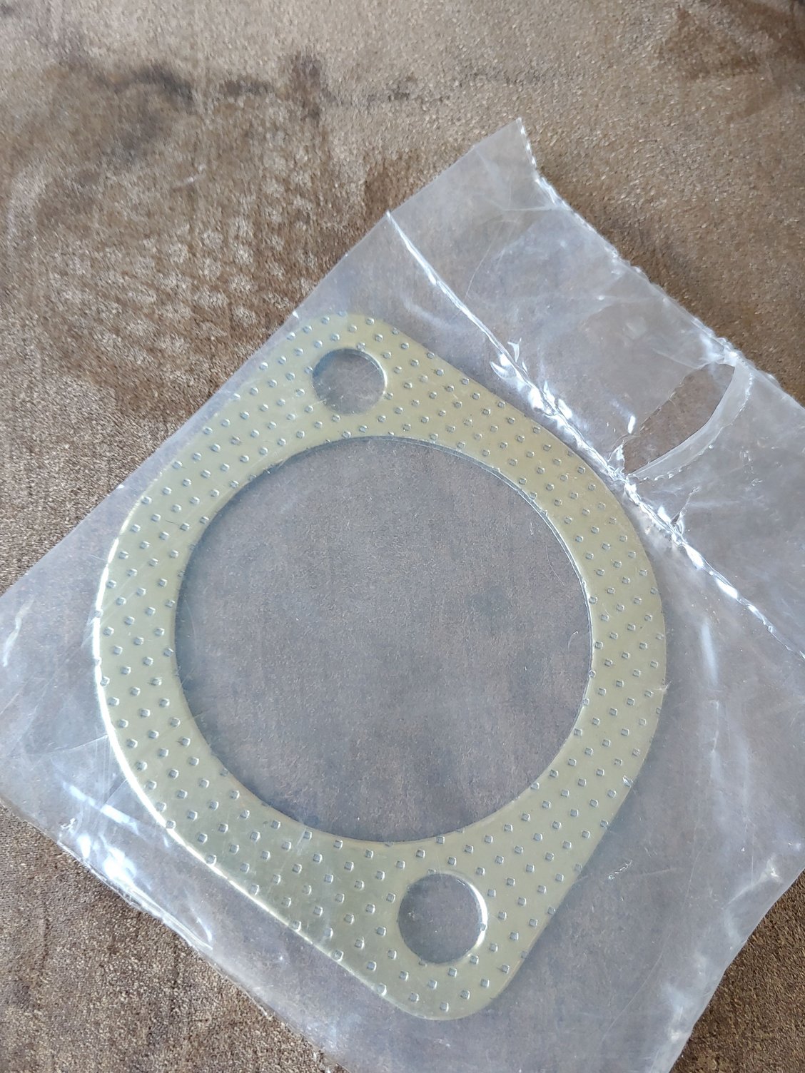

Pretty straight foward for install if you have ever done work on your own car. Got the car on four jackstnads and worked from my back. I removed the old kit and mocked this new VRSF Muse Motorsports kit up. Only thing I added myself was my favorite brand of exhaust gasket (Remflex) to the adaptor from 2 bolt to 3" VBand section. The supplied gasket will work just fine but I had a new Remflex in my tool box. The flanges on the piping are all heavy duty and the welds look great compared to the old thin crap eBay setup. I installed everything and only tightened it all enough to get lined up. Used anitsieze on the 2 bolts and rear 02 sensor. Once it was all up in place with the help of my kids play wash bucket. I moved onto final alignment.
