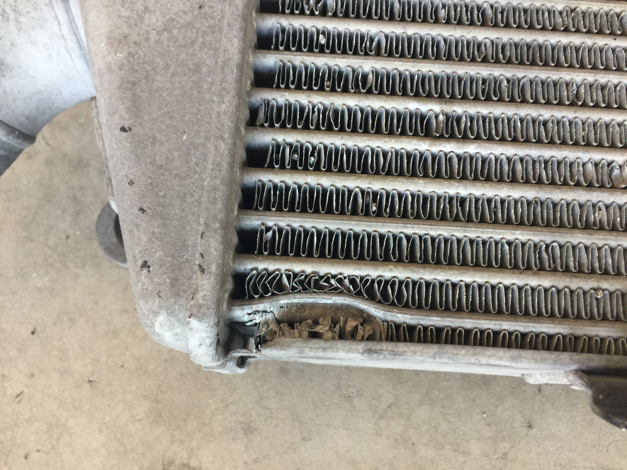

In my case I had the previous OEM intercooler get some minor damage due to the steep angle of my drive
way. I bought another OEM one because I had been waiting on an aftermarket unit for 5 months which was ordered from Japan. I have yet to install the aftermarket unit and decided to stay stock and tightened everything up. Car runs like a dream. Looking back now this issue with this intercooler is minor and I think the hoses were the issue.
