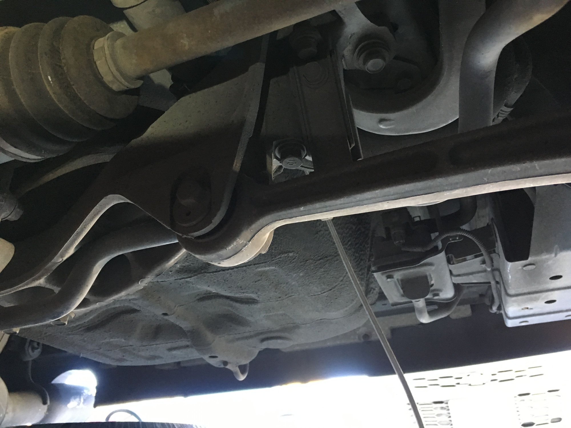

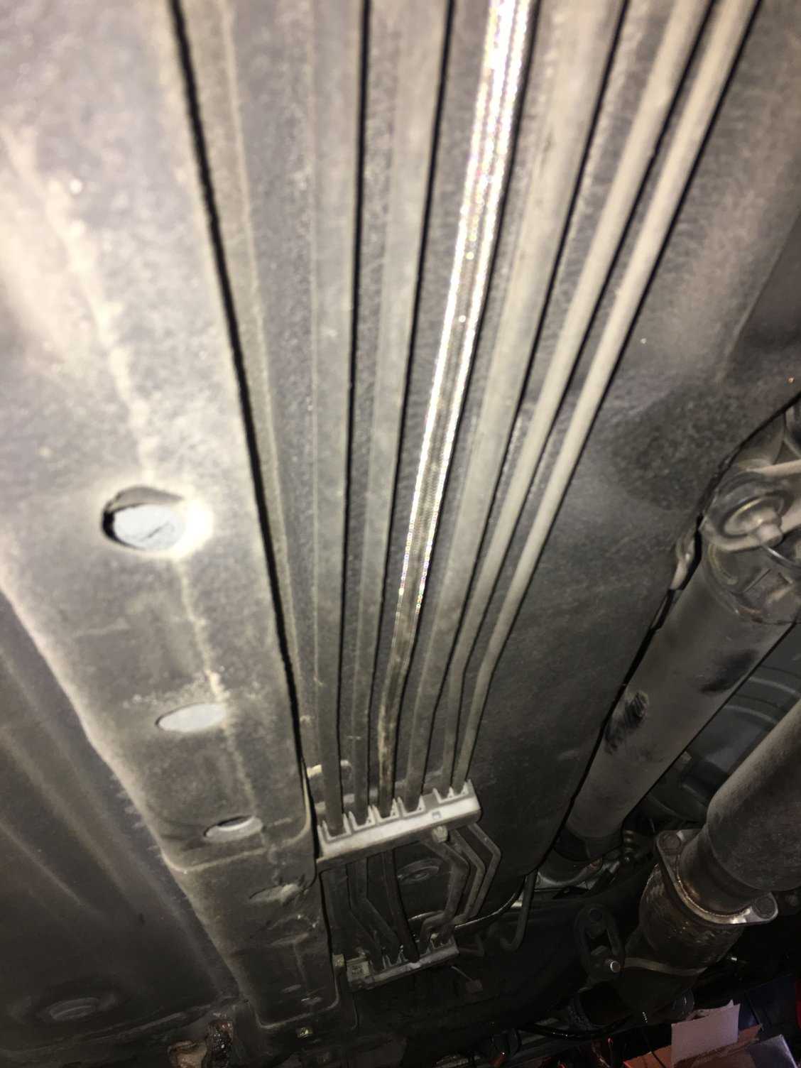

Forgot to update this. Just in case someone ever has this question (even though its pretty obvious once you get under the car). You're able to run the line up against the body of the car, around the one side of the fuel tank. Then I just ran it beside the other fuel lines up to the front of the car.
i this is before I secured the line with stainless rubber cable clamps.
