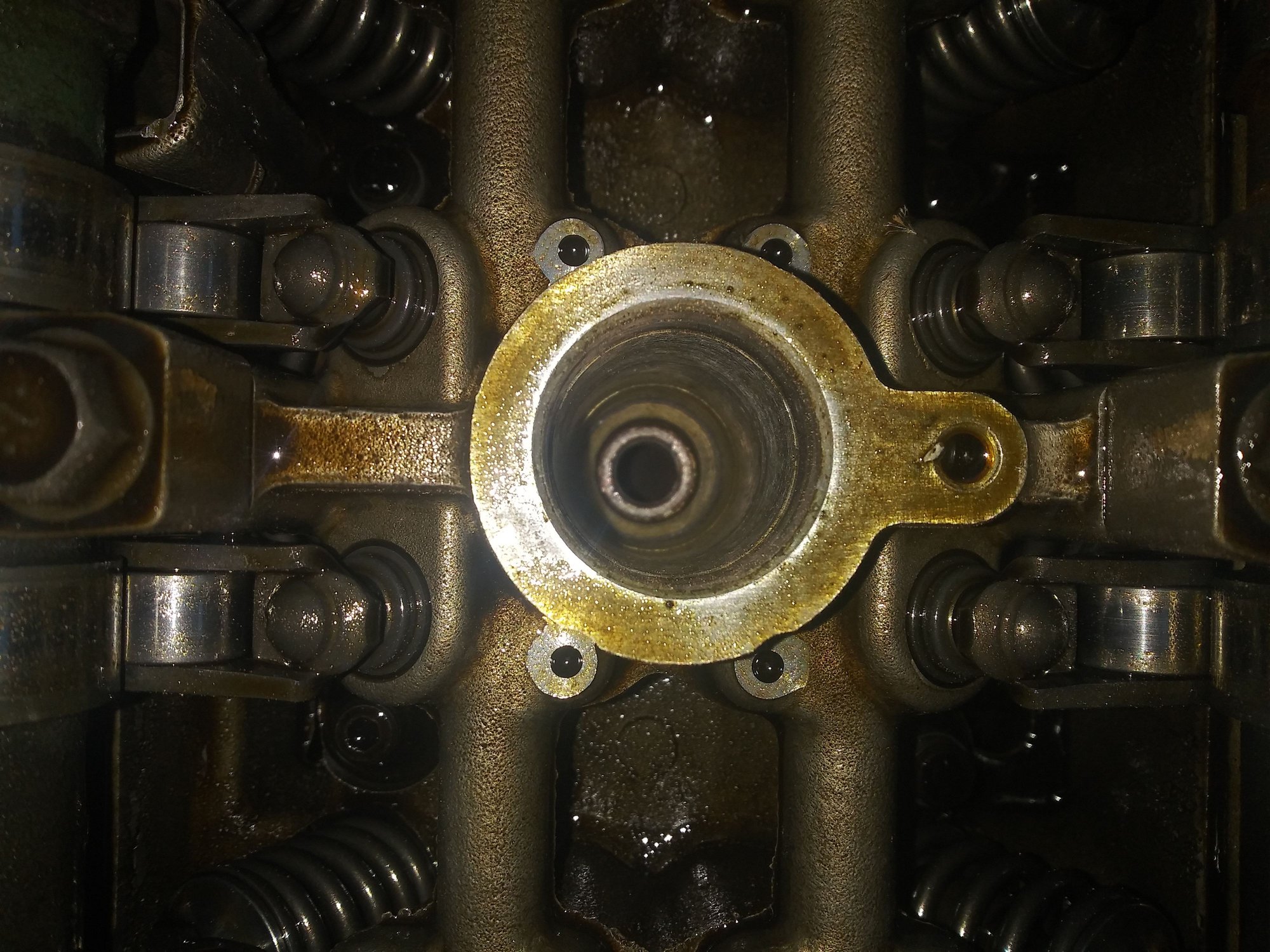

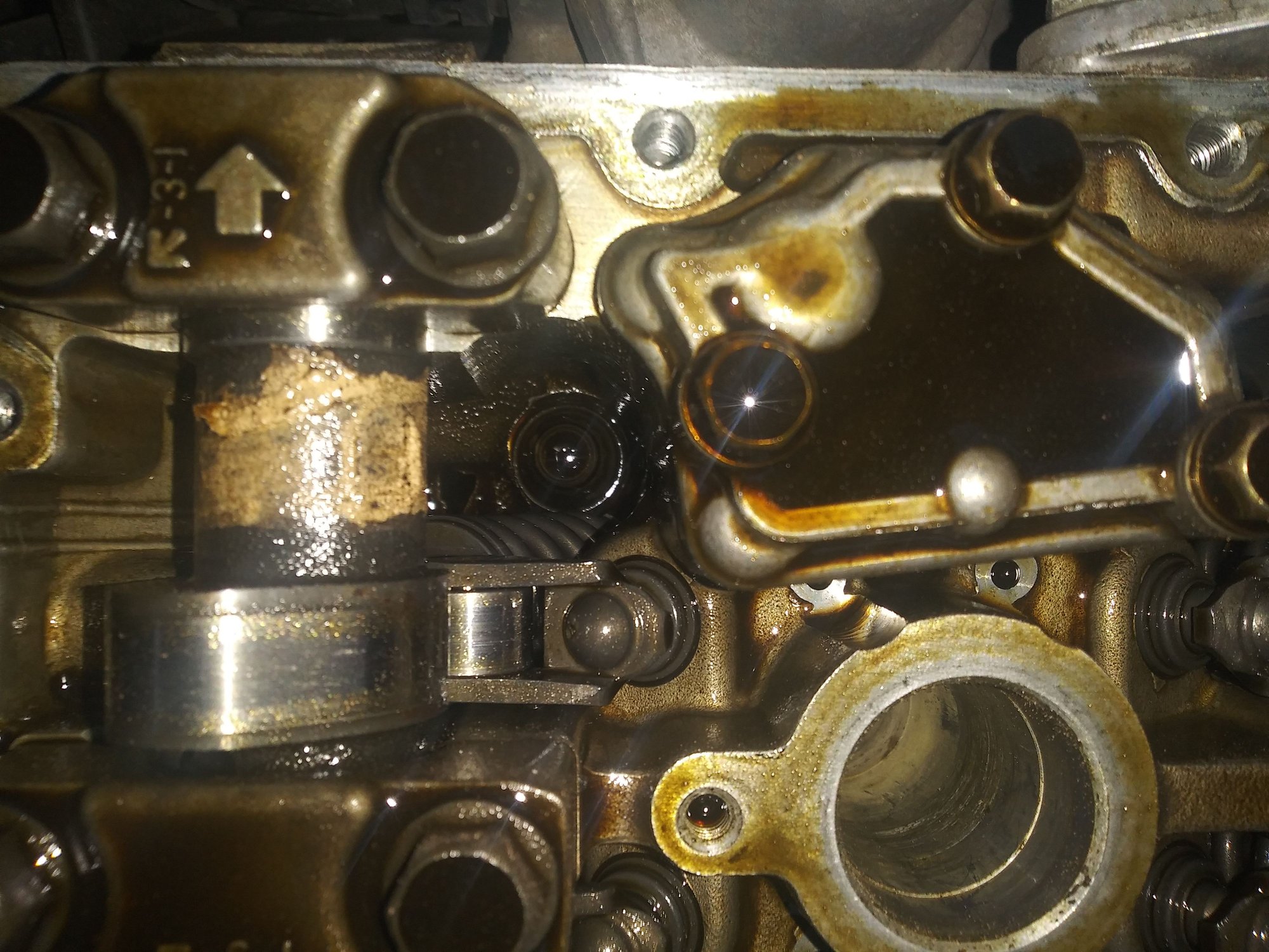

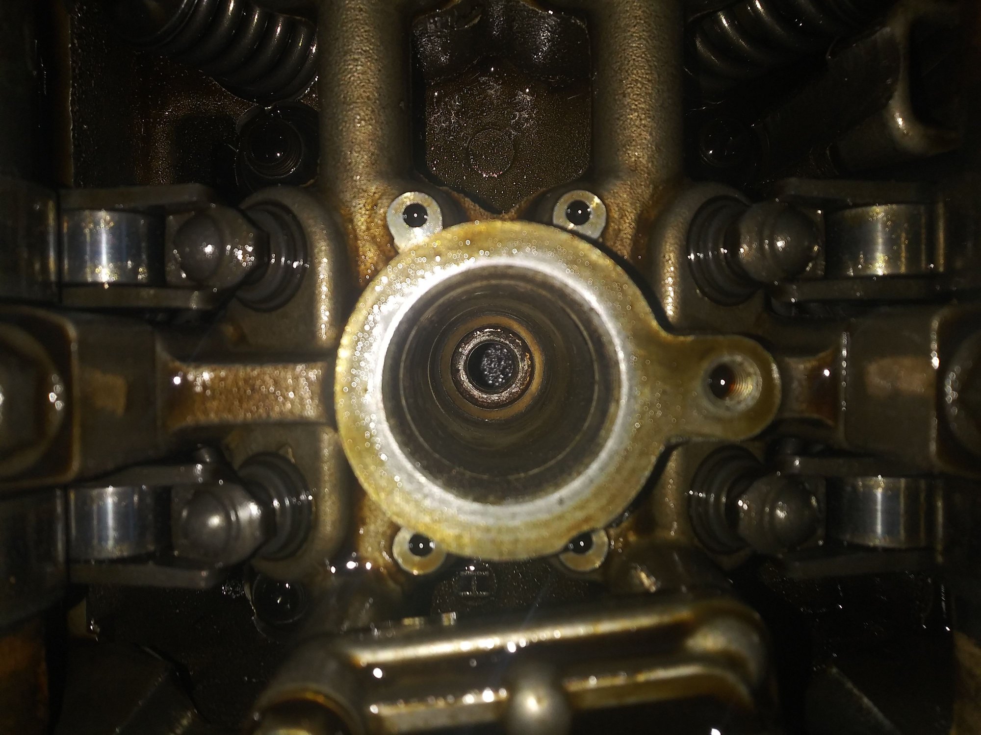

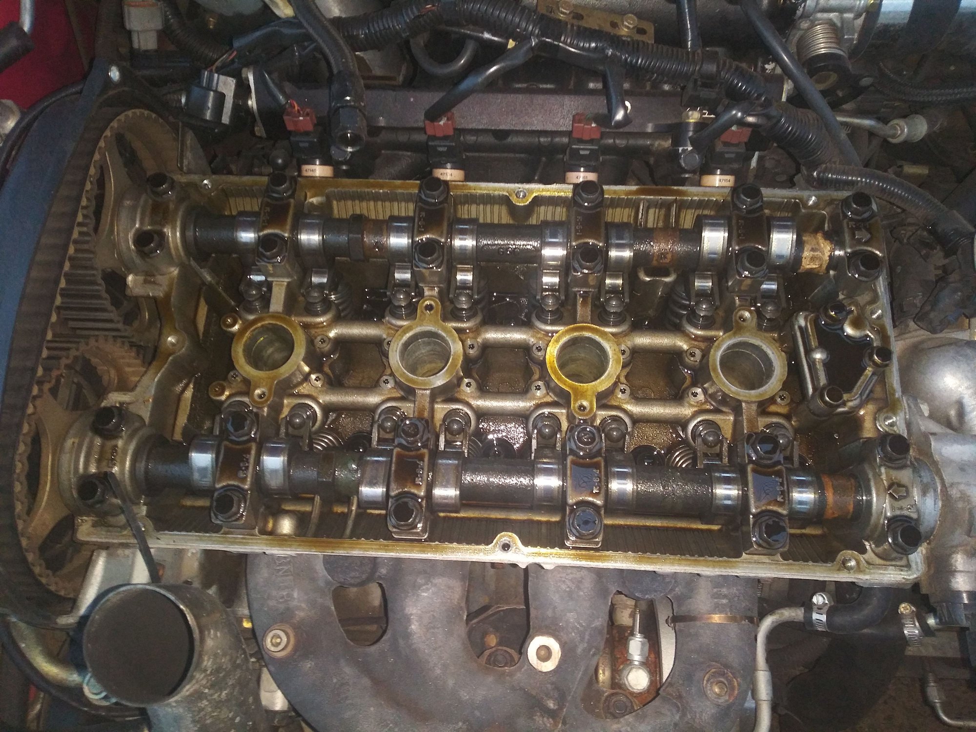

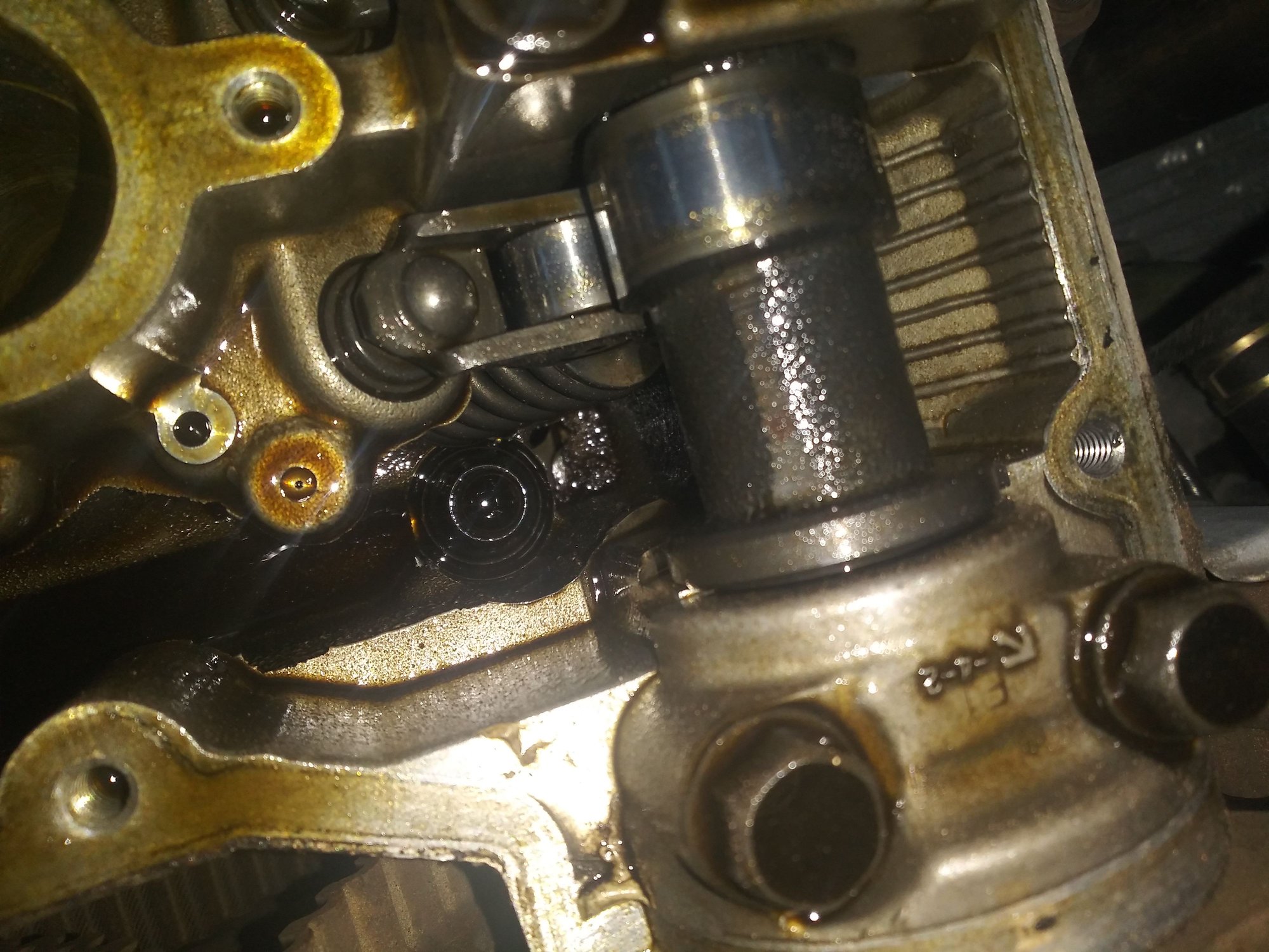

Ok so visually inspected heads, lifters, rockers, nothing out the norm. Things to note piston number four looks pretty dark and wet and the new spark plug looks more burnt too .
Cylinder 1
4 looks wet you can see its darker than the others
If you look close there looks to be cracked drain ports dont k ow if they are correct
Old Feb 22, 2019 | 07:40 PM
BNEDA53's Avatar
Joined: Feb 2019
Posts: 8
From: El Paso
Those ports dont looks normal amd were close to cylinder 4

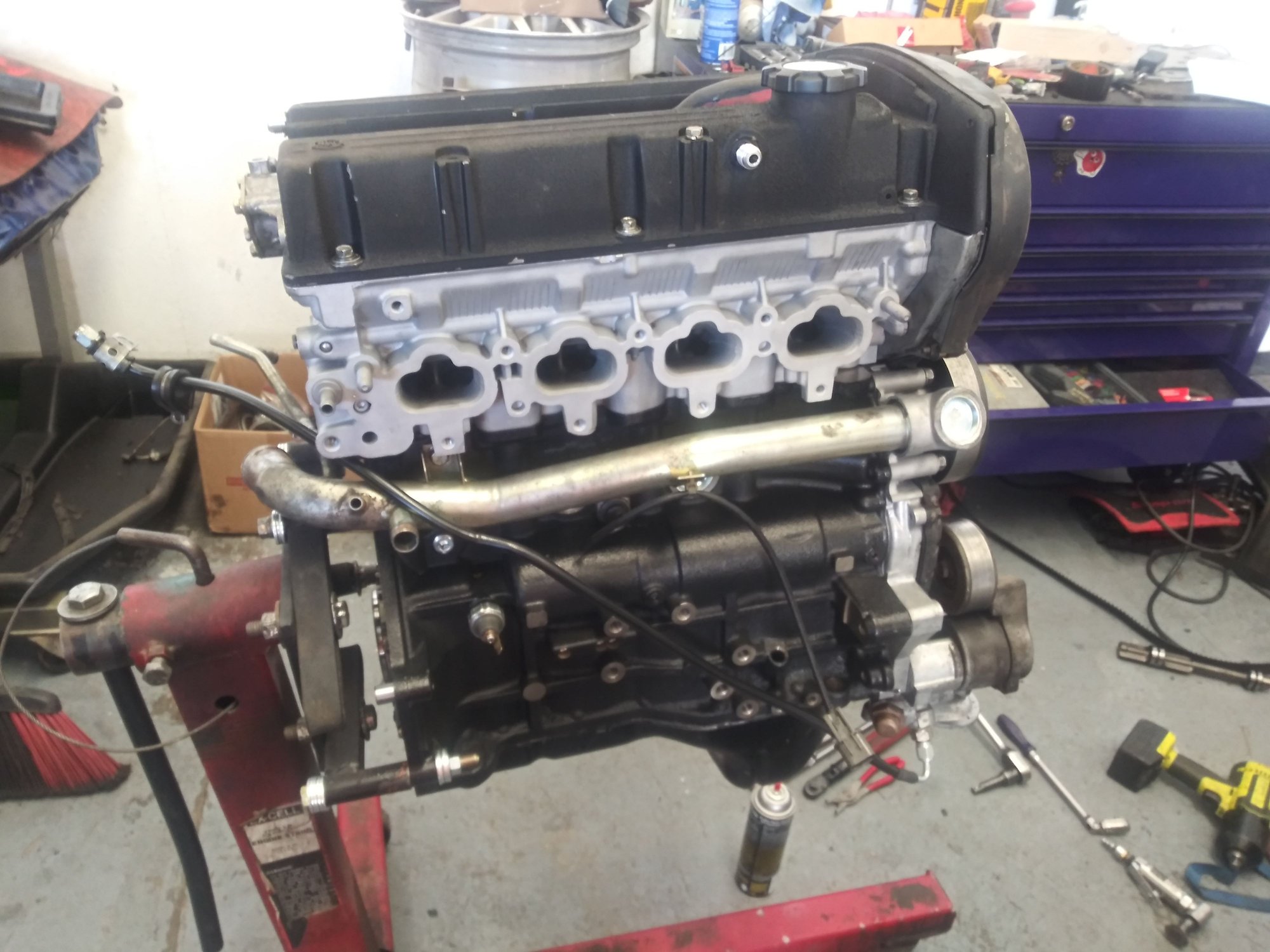

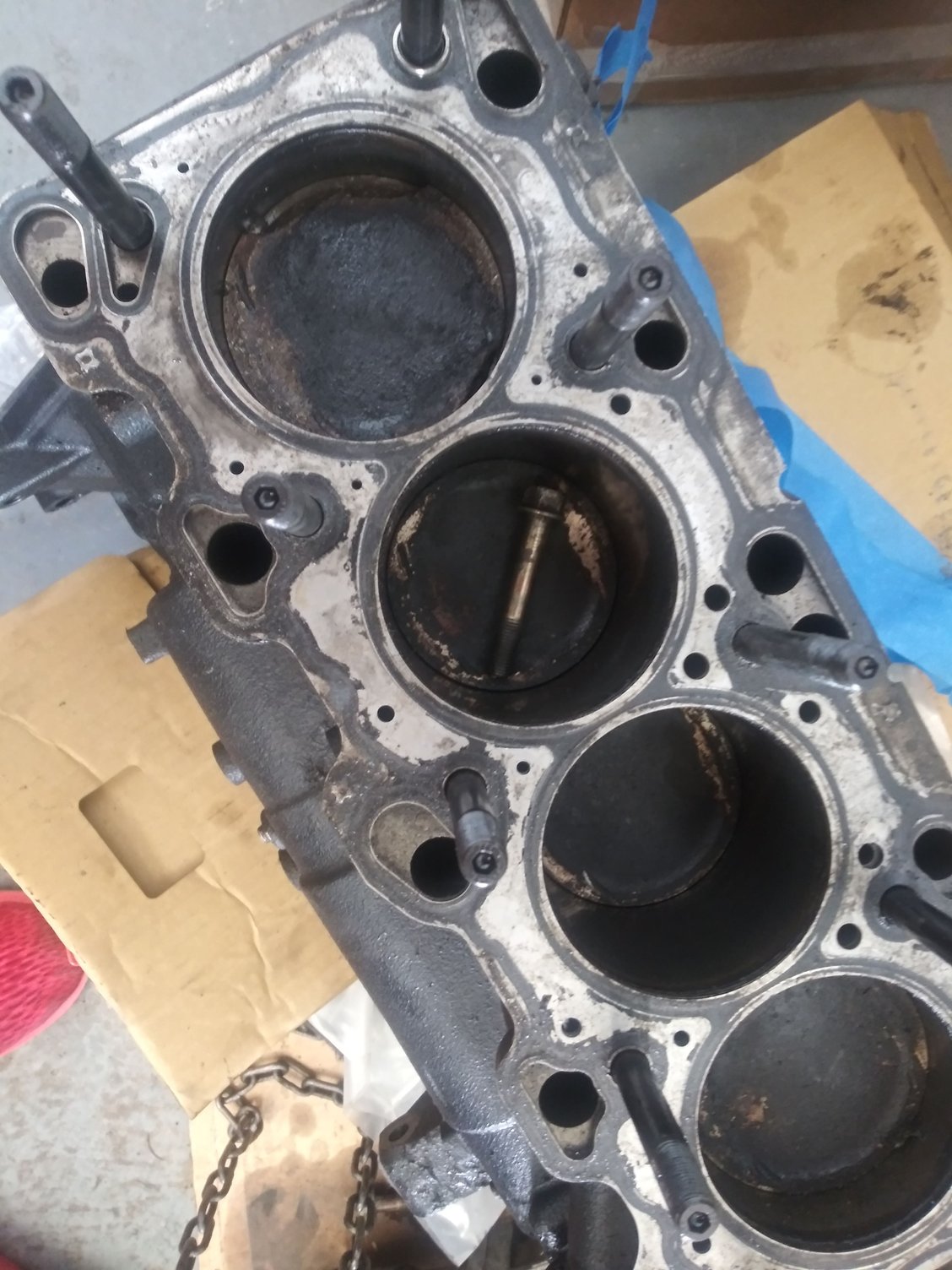

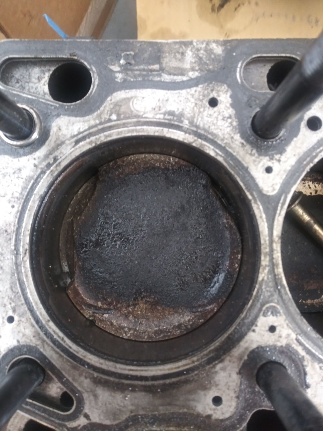

Yoooo Sorry haven't kept up with any updates or pics and stuff thanks for the feed back. So to update to current times turns out the piston ring got to tight blew a chunk off the hea. Ended up getting a new bottom end built and will use the old block to build as a spare or stroke it over. Also ended up doing a balance shaft delete no mini stub. so everything is back together. A problem I currently ran into is turbo. First one got starved second blew both Journal bearing. Checked the oil line its good actuator is good. Don't know what it is I ended up buying a BB FP Black so we will see how it goes. gonna save the old for for the spare motor rebuild too. Pics too follow. Thanks again for the feed back guys. Really appreciate it. Pics to follow.

Old block
Cylinder 1 Cracked.
Whole new bottom end. Had to get new valves The broken chunks messed them up. Also had to change a lot of tranny parts turns out previous owner beat it to **** changed the configuration to the eve 3 set up I want to say in order to accomadate the twin disk set up. will post pics when I gather the parts.
