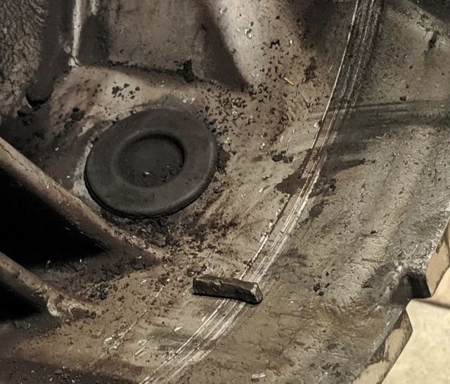

After having some weird clutch engagement issues, I finally took the transmission off to see what was happening in there.
A piece of the clutch disc had come off and was getting wedged between the pressure plate and bell housing. Bell housing seen better days.

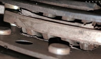

But, the weird part is what was happening to the clutch disc:
The springs were actually migrating outward, munching through the hub. Eventually this segment broke off after the spring cut through enough of it. Every spring was doing the same thing.
This segment was just about to go:
Any ideas what could have caused this? Poor quality clutch disc? (Old CM FX300) Bell housing bolt not torqued correctly?
I'm fairly certain my clutch engagement issues were stemming from the sprung hub not operating like it should, likely getting hung up sometimes. Thing probably was about to grenade entirely.

There were two different personalities to it. If I drove the car without getting on it much, like during a commute in traffic, it felt quite normal. No vibrations, sounds or strangeness with the pedal throw.
However, if I did give it the beans, suddenly the clutch pedal would get very loose and could feel heavy vibration through the pedal. Clutch engagement would occur maybe 1cm from the floor. A few pumps of the pedal and it went away though, returned to normal.
After seeing the disc, I'm thinking that when getting on boost, it torqued the sprung hub far enough that the springs got hung up in some way. Pumping the pedal while it was hung up may have been grinding the springs into the hub.
There was no transmission input shaft spline damage, and the clutch hub splines don't have any visible damage either.

I replaced the OEM clutch with another OEM. I then drove about 20K and then decided (about two years ago) to swap out the transmission (due to a manufacturing defect in the transmission). Any time the transmission is out I use it as an excuse to freshen up the clutch. One of the springs in the old disc was compressed and about to fall out. This with no launches and no hard driving at all. So, I'm guessing some maker of clutch springs made some bad ones and they got used in both your clutch and mine.

Bizarre. So it was a similar situation where the clutch disc was slowly acquiring more gremlins over time that likely would have ended similar to mine if it had been driven longer. I would have liked to check the clutch disc earlier but thinking about the effort to remove the transmission sent me packin every time I thought about it, until a couple weeks ago.
I think I'm going to conclude it was a manufacturing defect in the hub and springs and move on.
After seeing this video, I'm more certain the failure was a manufacturing issue (@1:14):
It's an S2000 clutch but same exact clutch manufacturer and same model number as mine. I remember mine rattling like that when it was new. I remarked on the rattle before the clutch was installed but didn't know enough at the time to know that much play was bad news.

I think you are right on track with the defect theory. That just sounds like bad luck and a failed disk. On the bright side, once a new one is in, you are golden! Bummer when a part fails, though. I had an Exedy clutch take a dump on me, once. One of the springs came out and logged itself in the pressure plate. It rendered the car useless. Oh, the mess it started...
