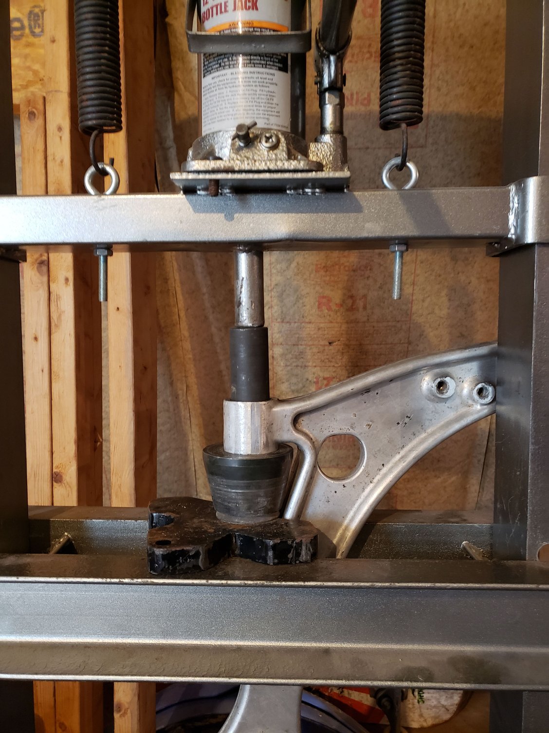

Yeah its exactly as Balrok mentioned. Essentially you just need to get creative with whatever resources you have at your disposal. Impact socks work great for a lot of bushings. Those master ball joint service kits usually have some dies that are useful but again youre not going to find a "kit" that has everything you need so this is where getting creative with metal scraps can save your bacon. That big donut bushing is just a hair under 3" so the kits I find while they will press it out end up getting stuck in the LCA. I have a hockey puck chunk of steel that I use now for that bushing.
I did this one fairly recently for a buddy. Again, use whatever you can that works. In my case, I lucked out bigtime and was able to use one of my cones from my wheel balancer as the receiver tube.

In my experience if you look closely there is almost always a chamfer on one side so that would be the side to press into as it'll help center the bushing. If not then just go slow and make sure its going in straight. It also generally depends on access. Rear LCAs you have ample access from either side so look for the chamfer. Front LCA like in the picture above you can only press out and in one way.
End of the day this isnt rocket science. Go slow and youll be fine.
