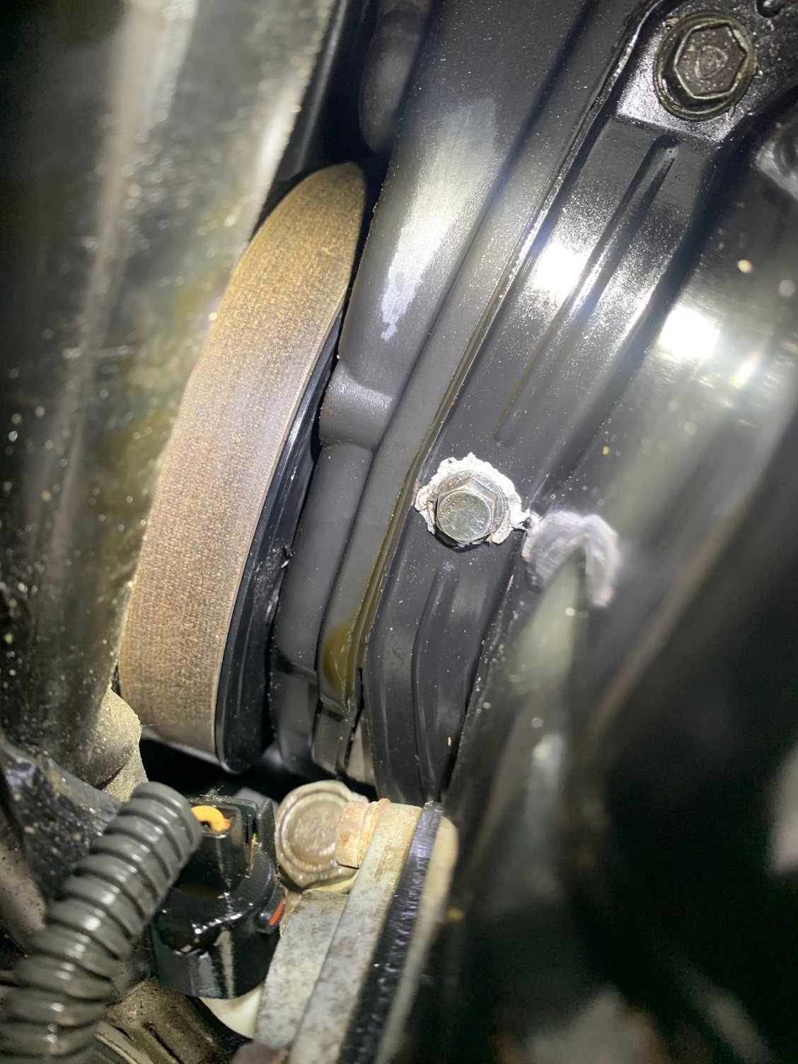

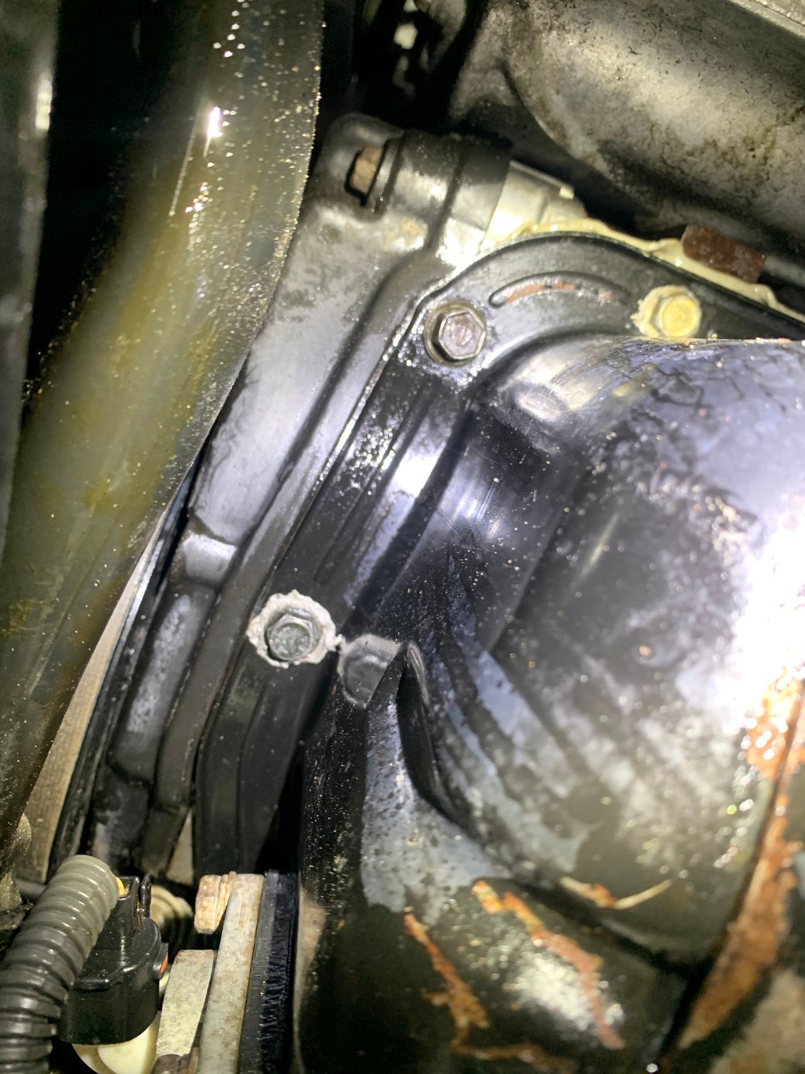

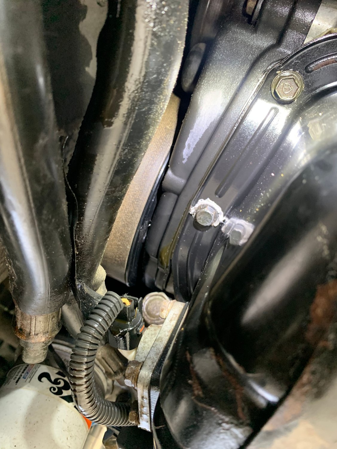

Hi guyes i saw now i hade an oil leak and wonder if u have some ides i have drove the car as daily and oil pressure is good at idl have some pic
This is after i 1 day

Take upper timing cover off, see if the cam seals are leaking.. if not, look down and see if it's the crank seal

Its reported that certain cars can have timing belt threaded bolt holes drilled into oil galleries. If you find a bolt with black oil at the tip and having thread sealer that thread sealer needs to be renewed when the bolt is replaced.

Okey i havent hade time to take off the cover yet so what you mean i just mabye have to charge the thredwear on that nut?
