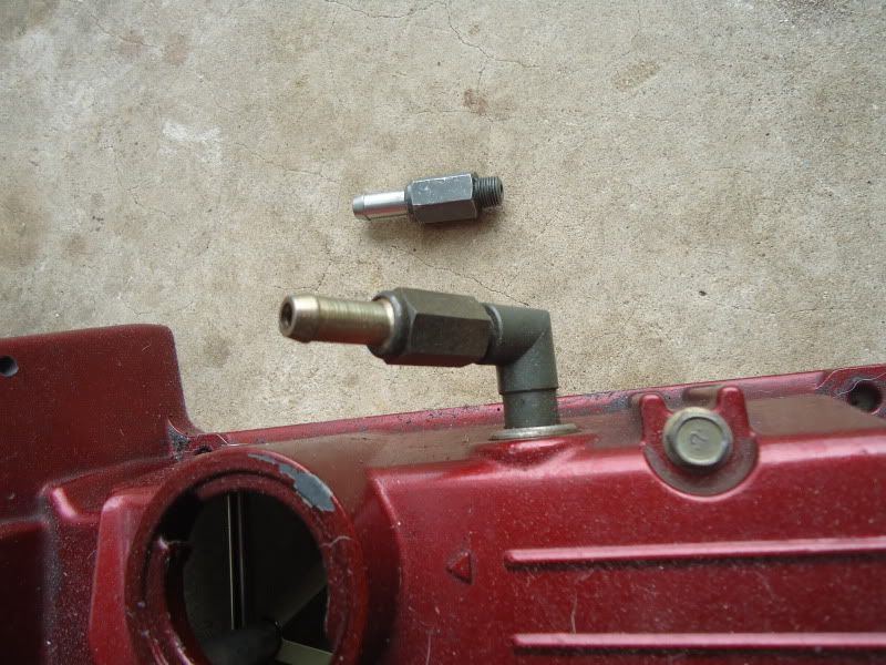

I'm new for evo just want know Can i just disconnect the stock hard tube from pcv fitting and using stock pcv fitting connect to the other catch can like cusco or whatever. Picture from website but i think stock fitting like this. Thank you for you guys help.

You can though, I’d recommend an in line check valve though. But it really depends on how much power your making really as this will increase Pressure in the CC. That’s the point we’re you’ll want to get proper -8 or -10an bungs welded to your valve cover.
To properly address any CC pressure issues, STM make some direct fit kits. I like that they run a line to the front Balance Shaft Inspection hole on the lower front of the block.

I run 24 with stock 8.5 turbo and just intake and exhaust. It makes 300whp not big deal. If use this connect to catch can is safe I'll probably just go this. I mean i love this cusco or greddy can looks.
