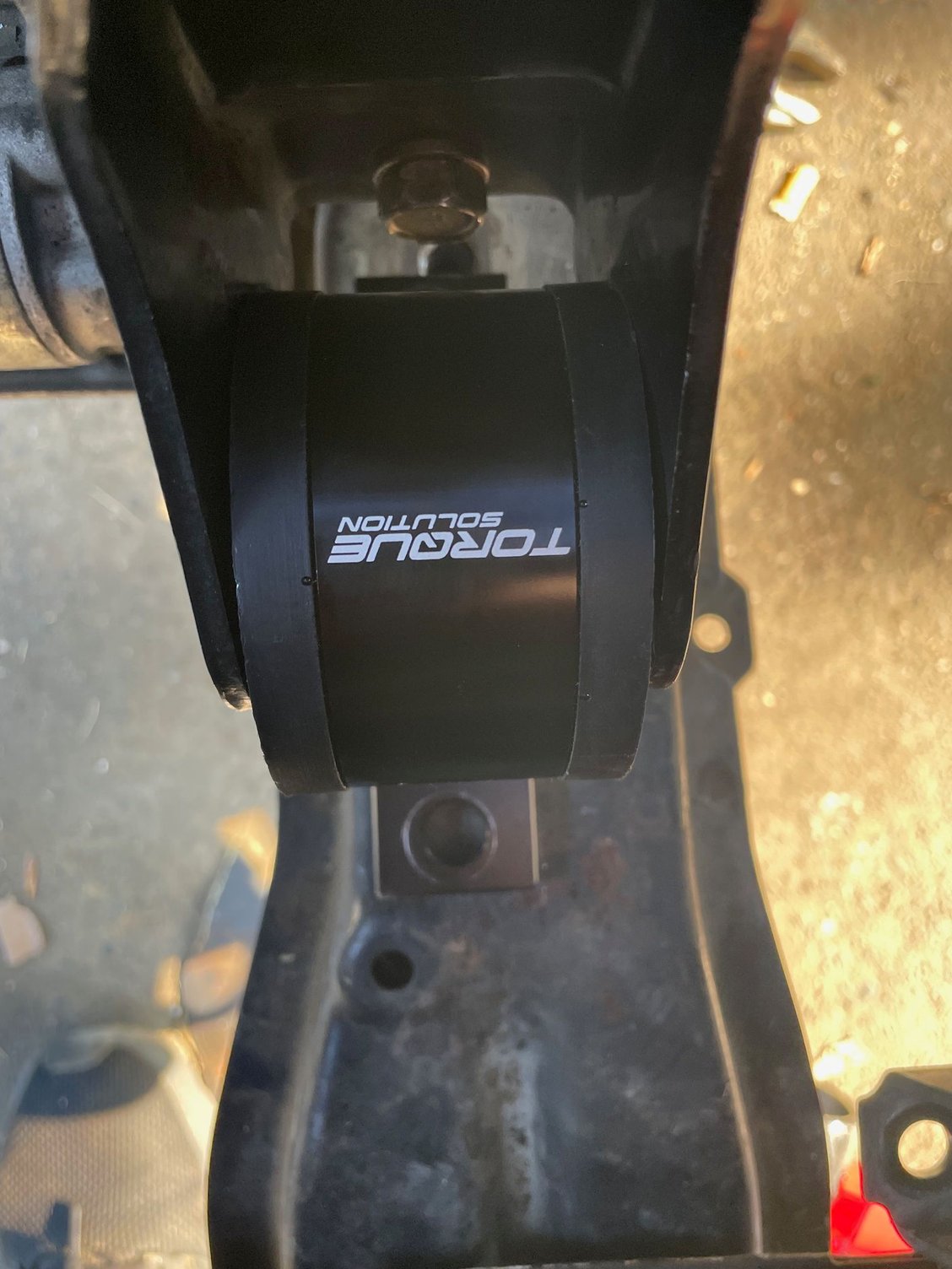

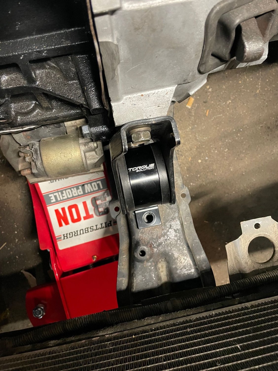

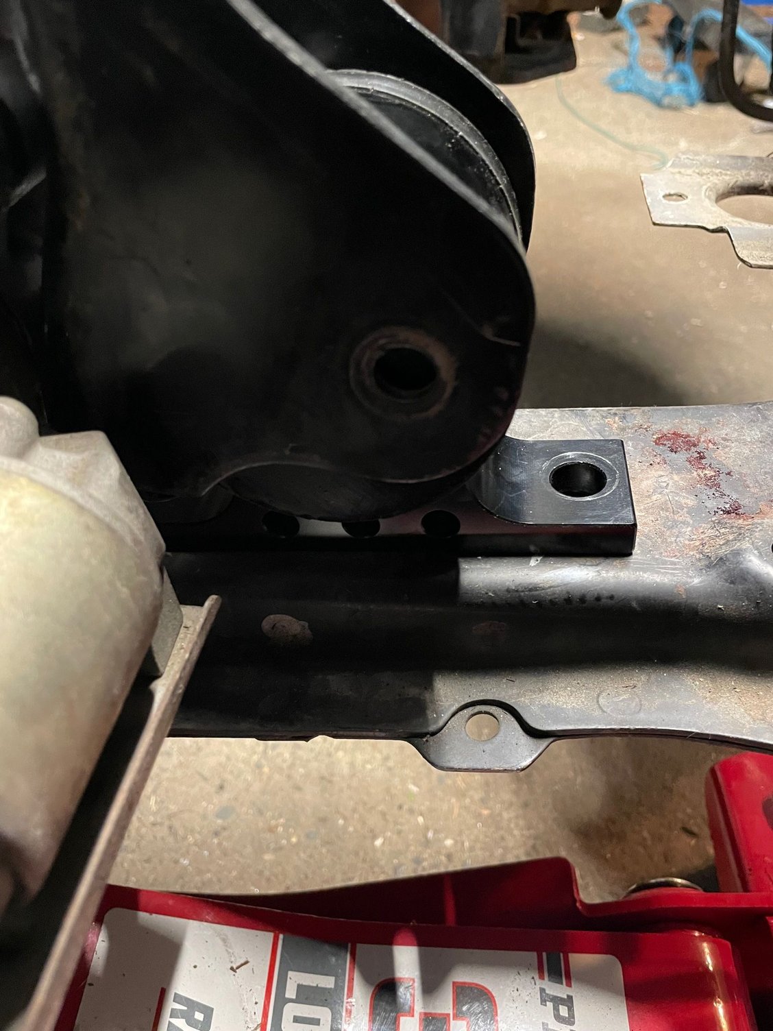

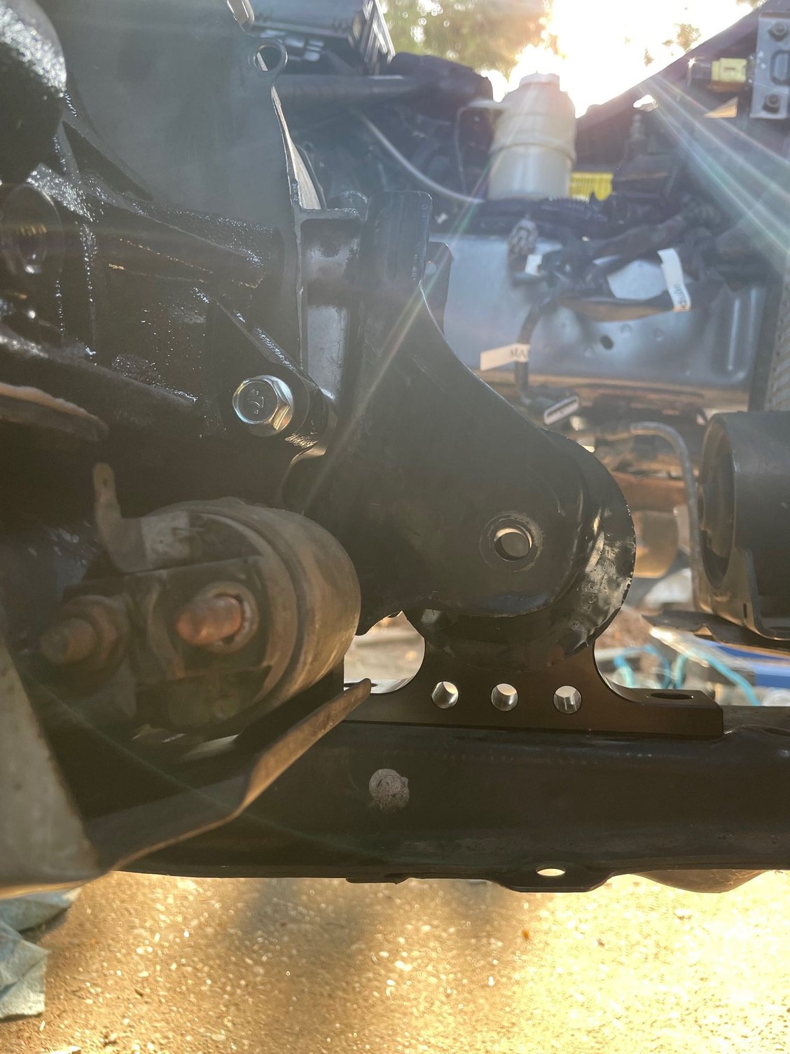

ill give that a shot today and see how it goes. Below ill post pictures of my issue.
Old Jul 24, 2021 | 09:00 AM
MrEvo9Mong's Avatar
Joined: Apr 2016
Posts: 114
From: Sacramento, California
So first two pictures is aligning it with the brace mount hole. The last two is aligning it with the actual front stop bracket. looks more than 1/2 inch off. Will try to loosen all mount and retry. not taking rear off cause that was a ***** to put on lol.

It wont line up. even when i loosen all three motor mount it just moves the whole car up instead of the engine. Im going to try the method mention above and see if that works.
