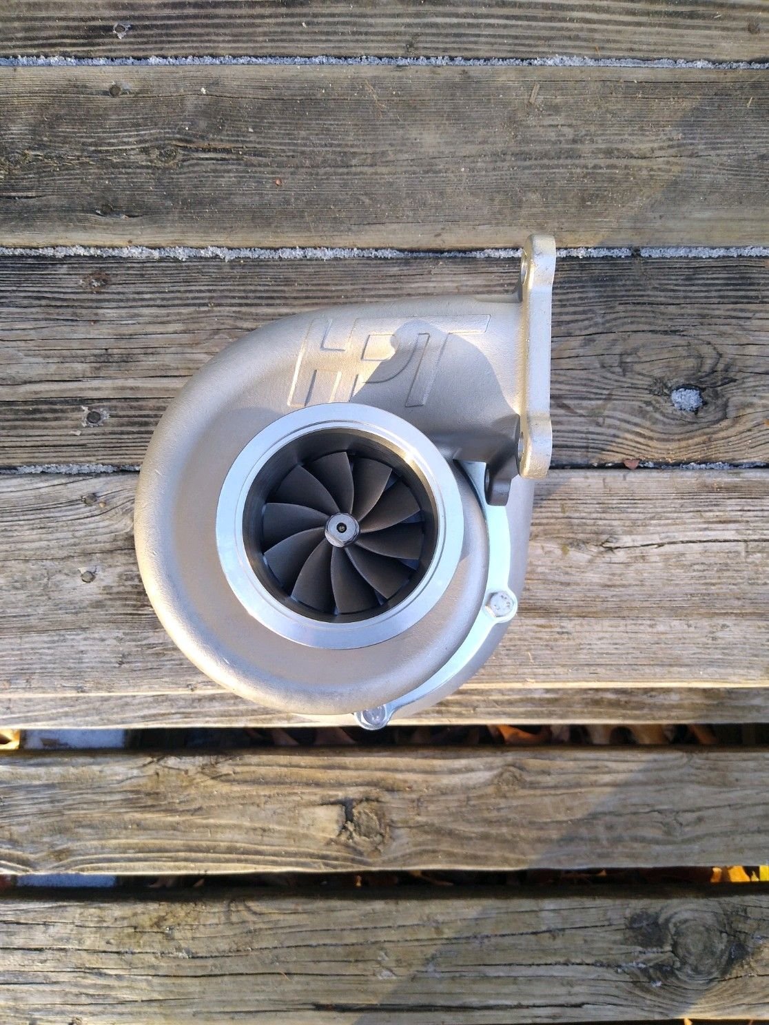

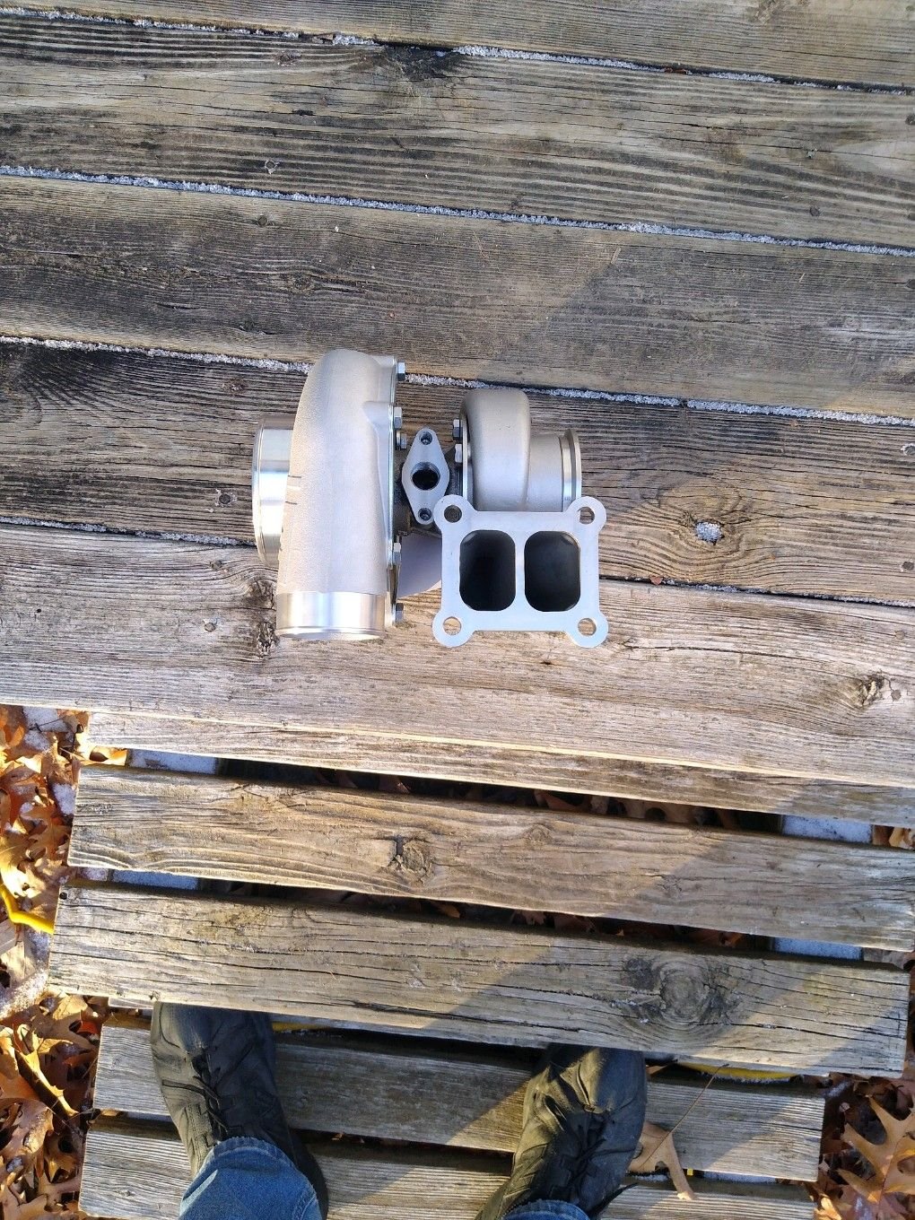

Well it is a little late arriving to my house by Christmas. But my present just showed up today. Check it out.
Brand new HTP 6466 with a 1.0 a/r in divided t4. This thing looks so small when I put it up to my s372 lol. I am taking the hotside to be coated on Monday. I can't wait to get it on the car and make 400 less whp lol. But with that said the car will have a much more useable powerband and be a hell of a lot of fun on the street. No more 12 lbs of boost by 6500 rpms, and no 3 seconds between shifts to build spool.

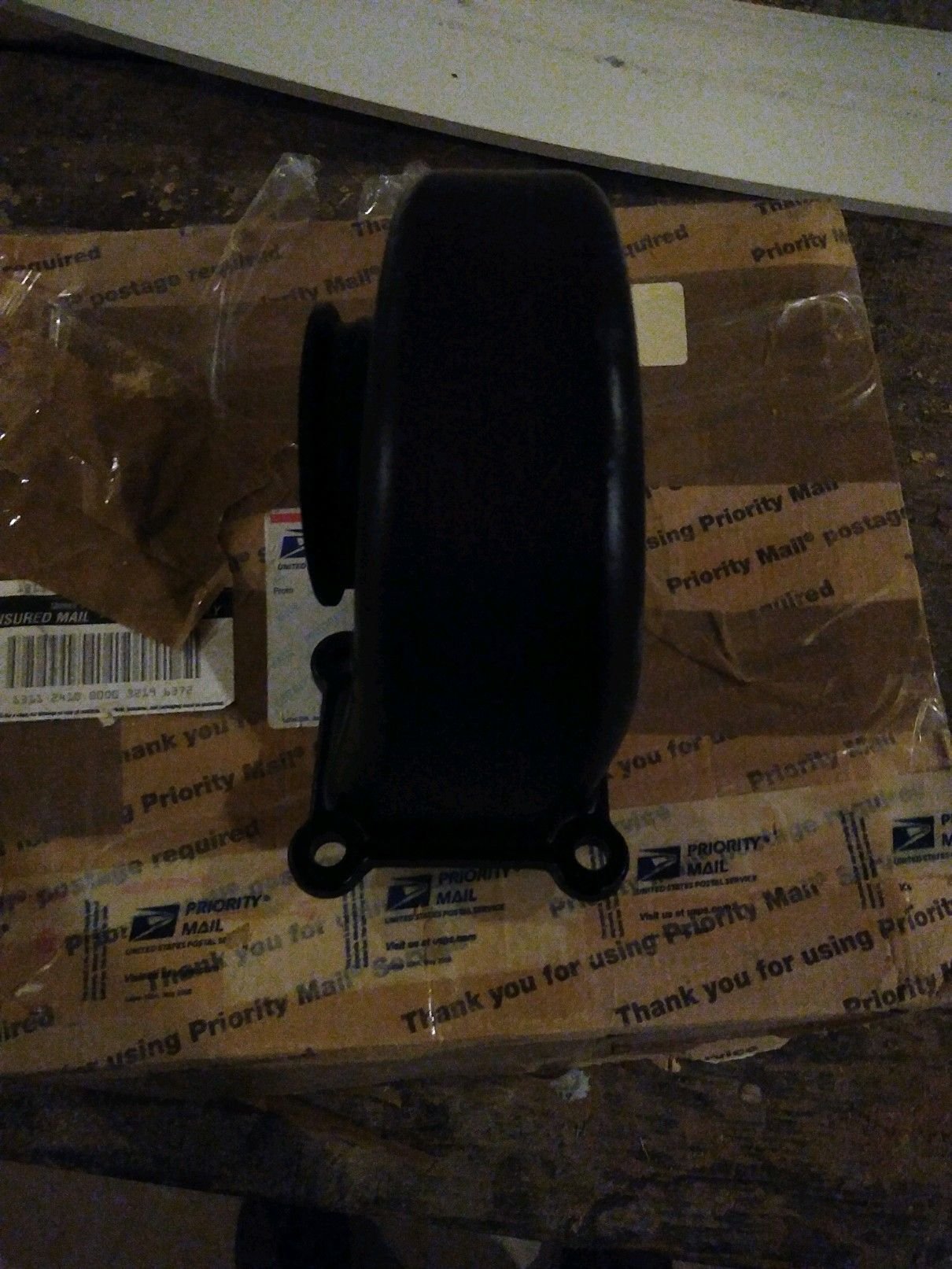

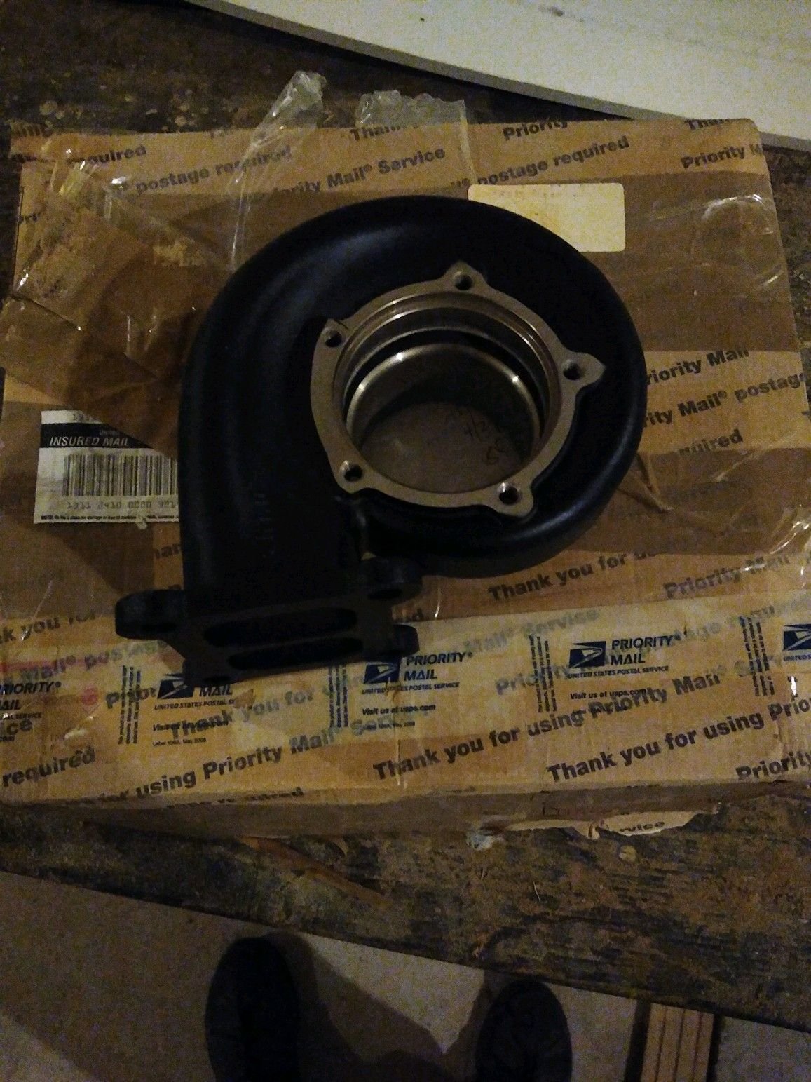

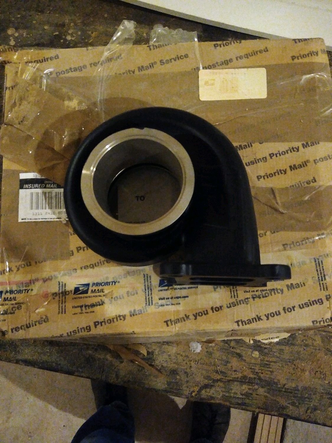

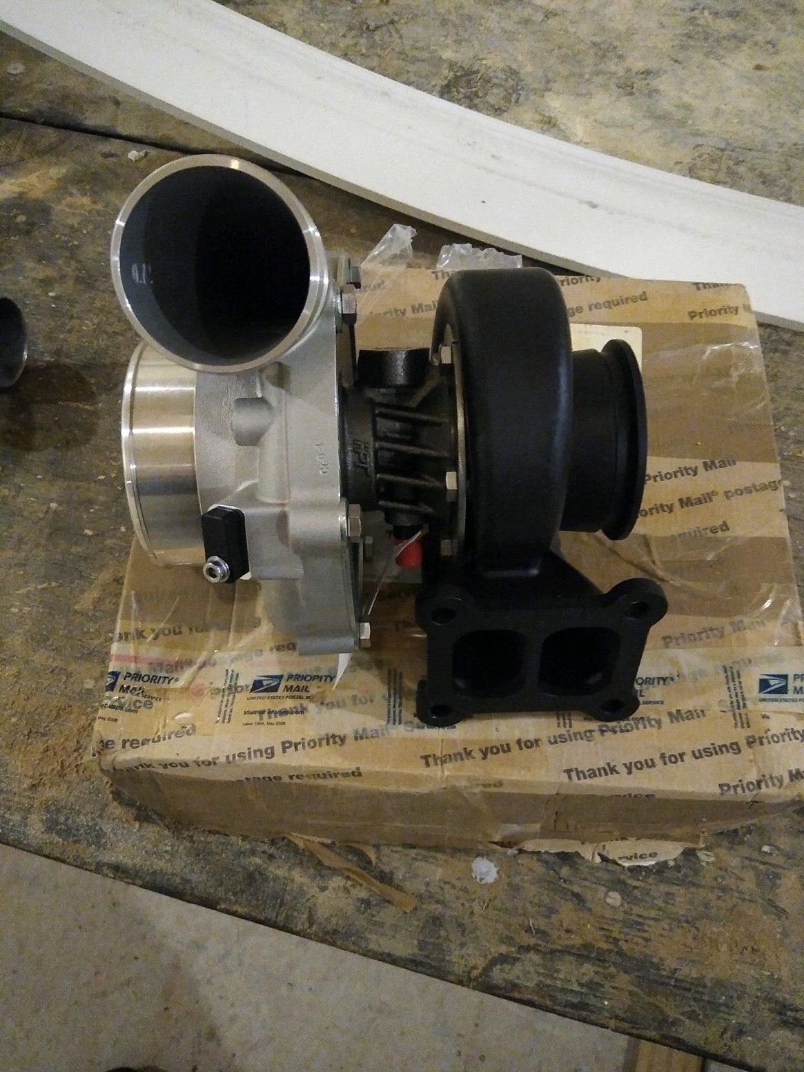

I got my hotside back from ceramic coating today and took some really ****ty pics lol. Note to self I am not a photographer lol. I am taking my car to a local shop and they are going to cut off the old flange off for the Borg and move it to the HTP flange and then once I get it back exhaust mani and downpipe will go to get coated as well then rewraped to make sure no heat escapes. Or maybe very little heat.
