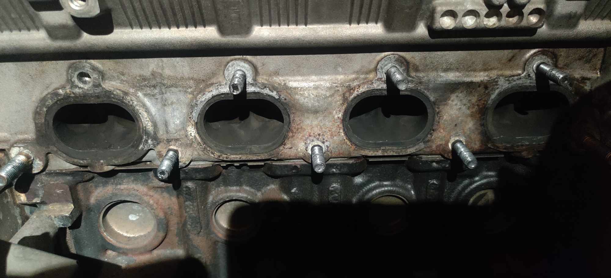

I'm having some trouble deciding on what to do with my engine. I have an Evo 9. I took out the turbo to get a broken stud drilled out. Kind of a pain in the ***, took the machine shop half a day and around 6 drill bits, cost me $200. Ouch. As I was reinstalling the exhaust manifold, a stud on the head started to spin freely at nowhere near the factory torque spec. It pulled the threads out of the head . I'm going to have to Time-Sert it. The question is do I do it, or do I get it taken to a shop.
Does this look like it desperately needs to be resurfaced/treated? The rust is a little scary to the inexperienced eye.
Bonus picture of intake valves looking quite dirty. Normal?

Do a compression and leak down test now. This way you can see if the cylinder head or block have any issues. This way you can pull the head and have the machine shop repair the stripped hole as well as any other cylinder head repairs.
You can install a timesert. Drill bits self center on holes. Tap the hole and go slow.
If you have the time to do everything yourself then you will save the most money. The hole is already there so the drill bit isnt going to be able to drill somewhere else.
