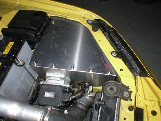

Tri-Bar, did the same box cut at friend's machine shop today and have ordered the K&N panel. I assume the noise level will be somewhat louder with the K&N. Great, simple mod. Thanks for the creativity.
Old Jun 23, 2004 | 08:45 PM
Tri-Bar's Avatar
Posts: 124
From: Modesto.Ca
Yes, It a little louder. Sounds better.

Very cool.. Nice job.. the only issue would be on cars where its not as easy to leave that airbox in place due to custom MAF pipe or intercooler.. Personally, I never experienced any stalling issues with a cone filter.. MAF Anomolies (running lean in places) I have had happen though..

Nice idea and cheap. Even if you have a cone filter an air box is a good idea. it will let you ducked cold air from the front air dam into the filter box! Norris Design runs one to good effect. You can use the stock box if you can get it to fit, then cut holes in the front and duct air off the bumper to the underside of the box. This is a common mod on EVO VI rally cars as they have problems with high intake temps (low speeds, high rpm).
On the "hot air is better than cold air", please read up and think about these things. hot air is less dense, i.e. less O2 molecules per volume. As the maximum negative pressure you can get is -1bar you want as many molecules of O2 in the air you pull in as poss. therefore cold (read dense) air is better.
Hot air has a similar effect to running a car at altitude. This is way on really hot days (when you are used to cold weather anyway) you feel slightly breathless and tiered!
With spool up, YOU NEED COLD AIR!!!!!! Cold dense air allows the N/A side of the engine to perform better, producing more exhaust gas and therefore reducing spool times!

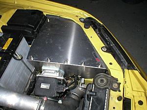

that is a disaster...come on guys you are going to be getting heat soak with a mod like that.
get a propper box and a propper filter

that looks cool mate. any more info on it? be nice to remove the headlight and get some "ram effect"! is there much ducting on it?
Chris.
Old Jun 25, 2004 | 04:02 AM
robvii's Avatar
Posts: 33
i have installed some cold air ducting into the box. however this is not part of the kit, it basically uses the gaps around the light and body etc etc to draw in the air. after a hard drive you can touch the box and it is cold to the touch. a good testament to its ability to stop heat soak.
its really simple piece of kit, a lid and a side. very reasonable too. i got it shipped from www.takakaira.com to the uk for good money including the apexi Power intake.
it is also a handy cubby hole to bolt your orm boost solenoide to. keeps it nice and cool
