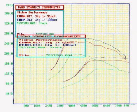

It can be summarized like this:
You want to shift at the point when, taking gearing into account, you will be putting more torque to the wheels in the next gear than you are in the current gear.
If you have the torque curve in a gear and then overlay onto that the torque curve of the next gear (rescaled appropriately), it turns out that even on a stock EVO this point comes near 7000rpm (in lower gears). With even minor modifications, this point comes near or after stock redline. This is why most reflashes raise rev limits: not because there is a ton of torque past stock redline, but there is still more torque in that gear than in the next one.
The graph below is three torque curves in 5th gear, overlayed on top of three torque curves in 4th gear. The vertical axis represents wheel torque (relative scale). The horizontal axis represents RPM's in 4th gear. You can see that the tuned curves' torque does not ever fall below the next gear torque (prior to redline), while the stock torque curve crosses the next gear's torque curve around 7200rpm, indicating a good shift point.
