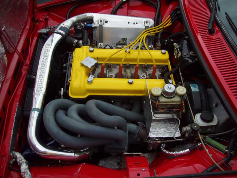

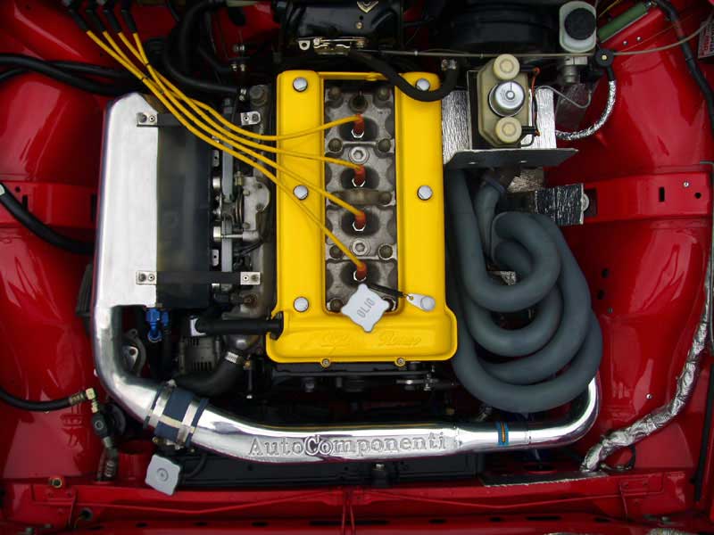

Here is a pulse converter manifold on an Alfa 2.0 turbo. The turbo is an old T04 converted to twin scroll. The primaries are ~30 inches and are ceramic coated stainless.
Originally the engine made 240 WHP @ 15 psi.
With the twin scroll the engine made 234 WHP @ 10 psi and 283 @ 15 psi. Lag was improved though I would like to see what a modern turbo would do... something like a GT 3017 or GT 3540 or something similar. Opinons...?
Fenris... you seem pretty knowledgeable here...
-Brian

my engineering friends tell me that twin scroll hurts top end performance, so we run 4 to 1 merges on our racecars.
it made the whp show above on 1 bar and 1.8 liters.

JDB... I am open to your opinion... what evidence to you have to support your statement?
-Brian
PS I am running an air/water IC too.

JDB,
Comparative analysis can be effective at times... however in this instance I believe there are too many variables to substantiate your current position, that is why I asked for evidence, not anecdotal reference.
800BHP or more is easily achieved with an air-to-water IC. Questioning how long that power could be sustained would be a more telling question.
An equivalent to my motor (the Alfa above) has set a Land Speed Record at Bonneville running 24 psi and a small (ish) water-to-air IC. You should also know 35 pounds of ice was converted to gallons of warm water by the end of the run!
-Brian
