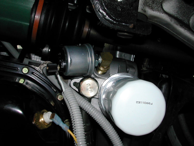

hmm.... that thread tells you where. It's right on the oil filter housing, above the oil filter. There are 2 ports you can use on the housing. Look on page 2 of that thread and it will give you the specs of the adapter fittings to use for mating up the the ports. You'll have to check what the specs are for the senders that you gauges use to mate with the adapters aswell.
Here you can see the oil filter(white), the oil temp(on the oil pan also double up as a drain plug) and oil pressure sender above the oil filter.

You're removing things you don't have to. You've got to get under the car to see it. It's on the passenger side next to the oil filter.

You are looking on the wrong side. Stand in front of the car and look at it. It is on the left/passenger side down where the oil filter is.
