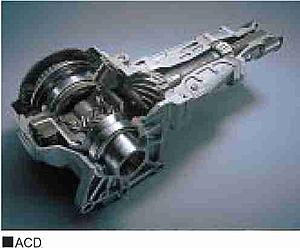

Originally posted by S_rangeBrew
Center diff is in transfer case and is also viscous
The EVO drivetrain doesn't have a transfer case.
Originally posted by Fireball
I believe that's wrong. I think the front is viscous and the rear is definitely a 1.5-way limited slip diff
What are you talking about. A "1.5-way LSD" is not a actual design for a differential. There are multiple different mechanical LSDs which can be configured in a 1.5-way setting. I think you have been playing Gran Tursimo too much. Next you are going to want to perform "level 2 weight reduction" on you car.

Re: Re: Final Specs Released!!!!!!
Sorry to brake it to you, but the part that we usually see as the ACD unit is the transfer case that has center and front differential in there.
Mr. AWD
Actually, see it your self:
