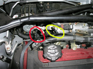

I just installed and Defi-D Boost gauge and I have one question. I followed the How-To but instead of tapping the line where the yellow circle is, I tapped it where the red circle is. Its seems to work fine. Does anyone see any problem where I tapped the line?

my friend tapped it where the red circle is and his readings are not as accurate as where i tapped mine -yellow circle

I actually have a boost gauge tapped on both lines. The boost gauge that came with the sports meter kit was tapped at the yellow line. I didn't like the psi measurements in metric so I have a boost gauge in psi mounted on my Apillar tapped into the line where the red circle is. Both work great and doing the math converting the bar to psi, they are both right on. In fact, the gauge tapped on the line with the red circle is actually more responsive (the needle mooves a lot quicker). I've seen boost gauges mounted on both lines and don't see a problem tapping into either line.

It's best to tap into the fuel pressure solenoid line.

yellow is the better of the two. if you want i can find you a thread that has this talked to death. ill search n edit when i find it.

and this is spost to be the best place to tap or this line is at least for the vacume / boost guage
v v picture where to tap vv
https://www.evolutionm.net/forums/at...chmentid=44050

I've tap mine to the BOV line.
And which is that? Yellow or red?
Mine's in the yellow.

My Blitz DTT DCII which has a electronic boost gauge is tapped in the yellow circle and my Defi-D Boost gauge is tapped where the red circle is...
