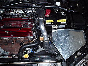

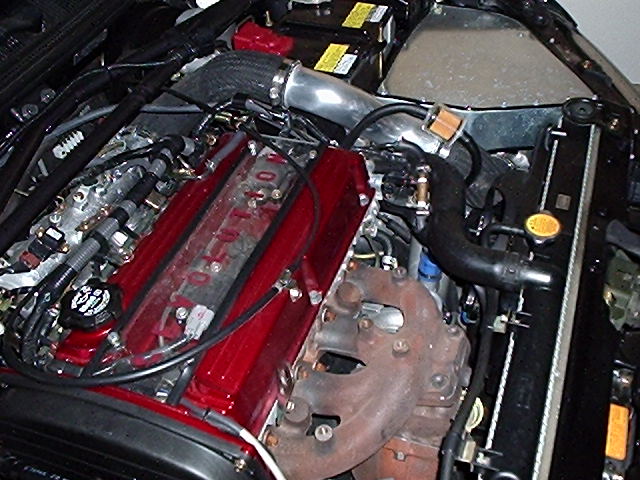

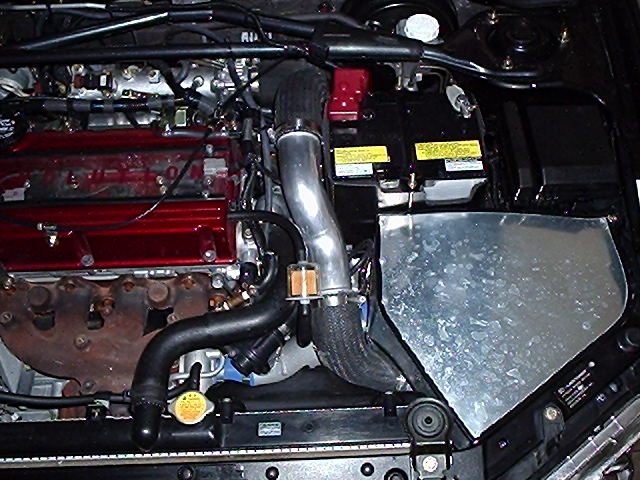

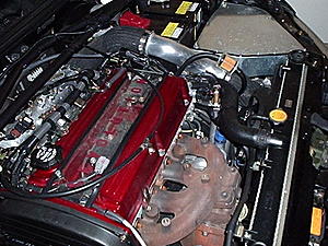

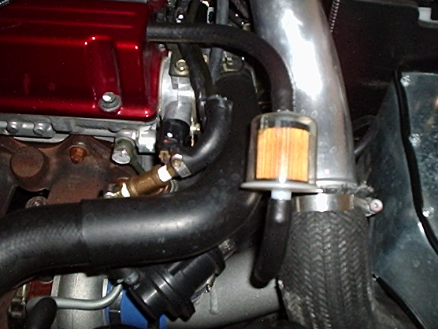

Old Jun 15, 2005 | 09:55 AM
Fa$[- a$ $hi[-'s Avatar
Joined: Feb 2005
Posts: 157
From: Cali
Here's my setup.
Attached Thumbnails Catch Can...-p6150001.jpg   Catch Can...-p6150002.jpg   Catch Can...-p6150003.jpg
