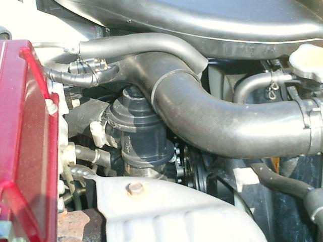

ok here is the picture.

the valve orenetation does not matter as long as it is recirculating. it works the same way. i actually run my forge diverter valve this way and it sounds great. all turbo cars run this differently.stock on the vw 1.8t's they all run it this way. so it doesnt matter because the air is still blowing back into ur intake pipe.

yeah, that is the wrong way shown in your picture.

Yep, that is incorrectly installed. I know that some have gone that with it. But I dont recommend it. BOV's and DV's are engineered to work a certain way. When you go against the design of the part then it doesnt function as well. They (not pointing any fingers here) think the sound is cool, and dont realize that they are surging/damaging the turbo. Yes, many may yell at me for that and many have written on this, but thats my 2c.

That is not true. There is only one orientation that is proper.

its not like the flow changes or anything. the vacume pressure just opens the valve to let the access pressure into the intake. its the same either way
