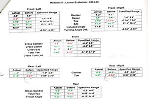

Here is my sheet from Sears... this is done on my 2005 with just Hotchkis Springs... no problems here.
Attached Thumbnails allignment problems - lowered on hotchkis springs-alg.jpg

after looking over my specs... before the allignment the toe was in spec and the camber wasn't.. so i know its possible to get the toe in spec.. maybe there needs to be a happy medium between camber and toe?
