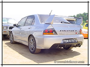

I just got my new Evolution IX last week and I can confirm that pickup of the engine and handling are both greatly improved compared to the Evo VII I had previously. Its a greatly improved car - absolutely superb.

that rear badge is huge on the 9
Old Aug 30, 2005 | 04:45 PM
Mitchubishievo's Avatar
iTrader: (310)
Posts: 4,287
From: Chicago NW Suburbs
Where'd you get that badge?

Evo IX Badge
The EVOLUTION IX badge on the trunk came like that.
Its just adhesive black plastic lettering but it looks great.

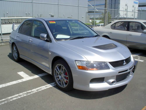

The car was shipped brand new from Japan to Trinidad.
Front view photo attached
Old Aug 30, 2005 | 05:23 PM
Karash's Avatar
Posts: 1,274
From: Okie in PHX
that front bumper is starting to grow on me...
