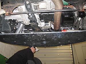

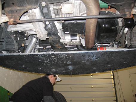

Dan @ MachV sells it for $249, which is the cheapest new I've seen ( http://machevo.com/cafifrsp.html ) Here are 2 pics of my car to show where the splitter ends. You can see clearly where the Oil filter is. It's no problem at all:

Yeah, you kind of do have to take the bumper off. The thing is the bolt are around the front of the bumper/splitter (see pic above) so with the bumper on, you can't reach them. Also, the splitter bolts to the car with the 2 bolts in the back of the splitter, which you can see in the pic. The good news is the bumper isn't that hard to take off... You do need a jack or lift though to get to the back bolts, especially if your car is lowered.

I've had mine on and off 5 or 6 times and I've never taken the bumper off my car yet. I reach all of the bolts easily and it goes on and comes off easily. I do NOT use the rods so I don't know if they requir ethe bumper to be pulled.
