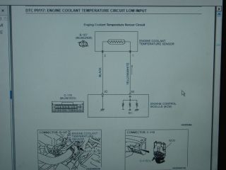

ya you beat me to it, I was going to tell you the pic was incorrect.
Attached Thumbnails p0117- need help-p0117-004.jpg   p0117- need help-p0117-003.jpg

thanks for the diagram.
maybe someone will use this later on.
That's the one.
It's sorta pia to get to, but once you get into it, it's good.

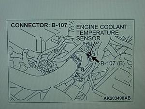

not the cam sensor, but the coolant sensor that's picture right there goes to the controller unit.
the first picture you posted are the one that goes to the dash to measure and display temperature.
The dealer actually corrected me on this, since I was going to order the front 1 pin sensor and the parts guy asked me which sensor I wanted. I described the problem, he gave me the rear 2 pin sensor.
Fix the problem.
thanks.

This is a photo from the genuine mitsu manual. It just so happens that it tells you where the cam sensor is in the same photo.
