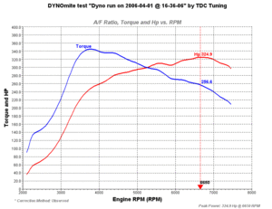

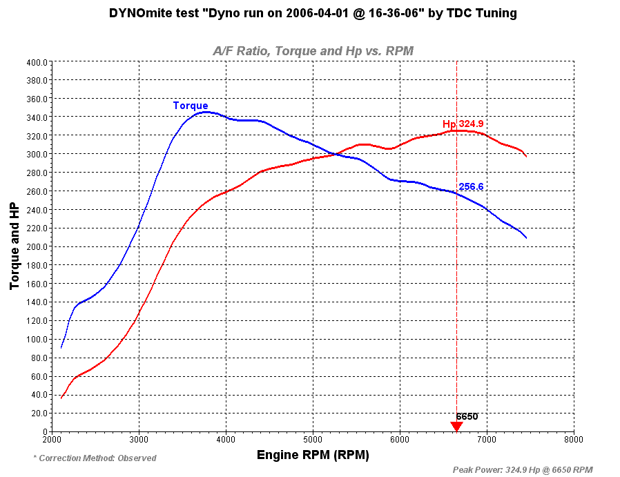

Finally got around to puttin my car on the dyno just to see what kind of numbers it would put down.
Power Mods:
HKS 264i/272e
Fidanza Cam Gears @ -2,-2
Walbro FP
Forge RS BOV (Recirculated) *
Buschur LICP *
Injen Intake w/ UICP
10.5 Hotside *
Buschur 3" catless TBE
DNP 02 Housing
Hallman MBC @ 24psi leveling to 21psi
Big Al tuned.
*Installed after tune.
http://youtube.com/watch?v=Ez2dGUPMNCk
Comments and criticism are welcome

Nice , those look to be some good #'s

Very good numbers. Do you know how much power you got from adj. the cam gears?

I never really got to fool around with the cam gear settings. I just heard from people that that was the best setup to go with and then drove the car down to Al to be tuned.

are you running 24psi on pump gas?
