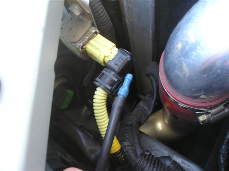

I bought a used 2003 evo and the intercooler spay is unhooked I think in looks like a stock intercooler so thats not the problem It looks like the line from the windsheild washer fluid tank goes about 3 inches then a blue end peice and it looks like the connecting line is about 5 inches away someone please help can I buy a new line or how does it hook up

Should be a simple fix right... ask someone to turn the thing on and find a hose that sprays the liquid then just hook it back to that. You can take off the bumper and you should be able to see all the hoses. Go to the How to Section I think there is a write up on how to take off the bumper.

Right off the bat, I think that you might be missing your "coolant resevoir" Can't tell for sure.
If so, a used one or a new one should be that much. most Mitsy parts are pretty reasonable.
Try to connect that hose to another one that is in some water ( like a water jug, etc..
) and see if the thing still sprays.
If you don't hear the pump, the fuse might be blown or missing.
It's a pretty simple set up once you confirm the electrical stuff is still in place and working.

the piece you're holding looks like the hose that comes from the resevoir, correct? the line that runs to the intercooler sprayer comes into the engine bay through a hole next to the headlight housing...if you don't see it then take off your bumper and find it...i agree, there is a "How To" on the bumper removal

He's right, the tank under the hood on an 03-04 is the IC resevoir - so that's the one you must be referring to.

there is a line that runs along the inside of the front bumper and it propably is just disconnected... check that out first... if the line is cut, then you might have to just get an extension... either way, i know because mine is like that cause i haven't changed the sprayer over to the new kit...
