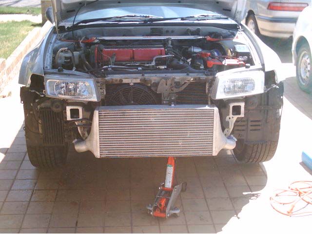

In case some of you guys were interested in what a pace intercooler looks like when fitted, here's a picture of my car with the bumper off and **** exposed.
Pace claims that all you have to do to fit this monstrous IC is to replace the fan with a slimer one (included in the Kit), flip the bracket for the powering steering bar that runs parallel to the radiator, and WALA! Yeah right, try having to shave a piece off the brackets that hold the stock fog lights in place in order to accomodate the new pipes introduced. Also, cut the pins that hold the main IC grill off because they just get in the way, and then maybe, just maybe your bumper will once again bolt on and fit. I guess Pace didn't expect people with GSR 5s to fit their intercooler on the car, considering the fact that the RS models didn't come with the foggers in the front. Or, maybe they were bias and only took the Evo 6 bumper design into consideration, and then claimed that their IC will fit both 5 & 6 equally without taking into consideration that the bumpers in fact do differ with both models. Anyway, It was worth it!
