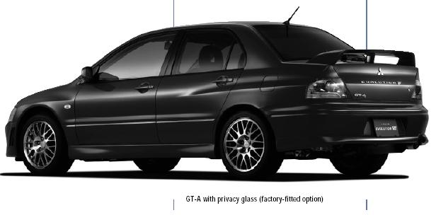

Also, the Mits brochure speaks of a low "GT" wing/spoiler. The R&T issue shows a Mits EVO "GT-A". Since there is no definitive on the issue, and one dealer said it looks like the "OZ" and another said it doesn't, I'm believing that a "GT" wing is what is on the GT-A. The Lancer wing wouldn't look right on the EVO anyway. There are too many body differences between the Lancer and the EVO to think the wing is the same one.

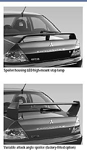

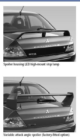

I was browsin around and came across a copy of the EvoVII GT-A brochure, which included pictures of the optional wings.
The factory installed wing is a low-profile with high stoplight, like the OZ:
It also mentioned however that an adjustable high wing was available as an option, as shown in the pic. Looks like the standard high wing on the Evos to me.
Obviously this was the VII, so no gaurantees, just maybe an idea of whats coming.

If that's the OZ wing, then that's the wing I was referring to.
The Lancer I saw did NOT have that wing. The dealer was trying to tell me that the low wing was what was on their Lancer, however, the wing on the Lancer they had didn't have that wing.
I like the GT-A's wing.
Thanks for the Pic. I'm not familiar with the Lancer as it's not a car I would consider for myself. (nothing personal to those who do)
Looks very nice, I like it! I'll take a short wing'd silver with sunroof please.
GR-VIII
