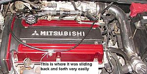

Also I looked at my Throttle body and it IS opening all the way.
One thing i was concerned about is that my throttle cable seemed loose at the clip on the front of the enigine. It could slide back and forth through the clip. So i pressed down on the clip so it held it tighter (not too tight thought to affect the cable inside).
I have attached a picture of where the cable was sliding. The gas pedal does seem tigher now, not so loose. Kind of seems like it has more responces quicker but that could be my imagination.
Attached Thumbnails want to hit high 11's before pulling engine-dsc006402.jpg

well i am soooo sorry for wasting your time AGAIN. but it just doesnt make sence. if at the track before i even upgraded anything I was running 13.8 then after thousands of dollars i am running 12.5 and you are telling me it is just my car? im sorry i dont buy that. And i dont buy that i need a new EVO. If it is running slower than other Evos it can be fixed. There is something that is making it run slower, it isnt just God saying "Oh I am going to mess with him." There is a lodgical thing that is wrong. And i just dont buy the fact that it is the whole car. It may be the motor, It could be a gear, it could be alot of things and i will find it. If i need a new engine then i will buy a new one, if i need a new tranny then i will buy a new one. Im sorry i just dont give up like other people, think that is why I consider myself a good mechanic.
And to the next reply.... Thank you for your ideas. But unfortunately it isnt the floor mat, i had that removed when it was dynoed and when i am at the track. It could possibly be a TB gasket. I did do a pressure test though on the system and it comes up with no leaks. But it is out there somewhere
