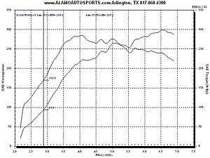

What kind of times should a 300awhp Evo measured on a dyno jet dynometer today run in the 1/8 mile and 1/4 mile asssuming a good 1.8 60ft time launch?
Before we run it Friday night, we hope to tune in another 30-45 hp by getting the fuel adjusted.
Now that my friend got his empirical evidence today, I understand why it pulled on up to 130mph as fast as it did. I'm hoping to get his dyno graph posted if I can get ahold of him again tonight.

Here's the Dyno Graph.

The car should run in the high 12's with an experienced driver. It could also run in the high 13's with a bad launch and missed shift.

I'de say a about 12.5, hope you do good! Also, make sure to get a video of it!

I would predict it would run from 12.5 to 12.8 - depending on how hard you shift it with a trap of about 107 - 109 depending on the tempurature
Interestingly - his graph looks very similar to my pre-emanage - SAFC dyno sheet
http://www.pruvenperformance.com/images/aldyno3.JPG .
You can see its very choppy - due to timing being pulled due to detonation
- Then after just installing the emanage and tuning the timing - we increase the trq way up in the low end by increasing timing - and take out timing on top - to get this very smooth post emanage curve
http://www.pruvenperformance.com/images/aldyno4.JPG
I shift very very gently so my 1/4 mile times are not optimal - however - I am making some new updates this week and should be pushing 400 wheel HP for the 1st annual mistsubishi shootout at Englishtown this weekend

Mister2zx3
Nice graph!!! What are the mods?
