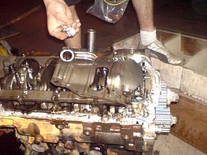

apparently, the previous owner of the car didnt take it to the right mechanic.. one of the piston pins wasen't locked.. and caused movement.. leading to breaking the connecting rod in half.. and the piston falling into the rotating assembly and crunching itself into a million different pieces!
