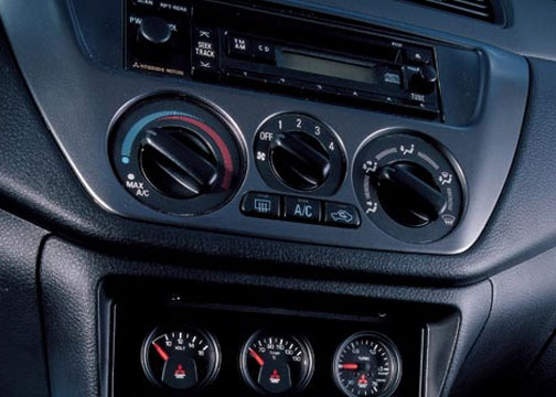

the ugly optional gauge pack:

you should switch the stereo and the gauges...it is much better to see and all...i did it...took like fifteen minutes and you need no extra parts....they are a direct fit....MUCH BETTER i must say...easier to see too

its real easy...you don't have to buy anything...i recommend using a kitchen knife when trying to pop out the molding around the sports meter kit...just slide it in the crack carefully and and pull strait towards the back
and when you are taking off the plastic around the climate control...after you pull off the nobs...just reach your fingers through those openings and pop the bottom two snaps...the rest comes off easily
