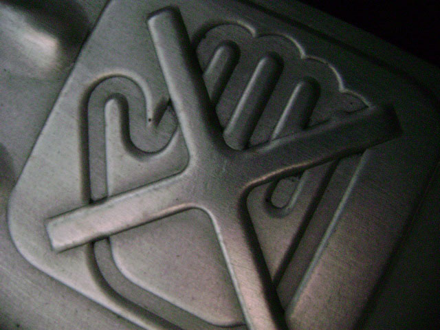

I have to apologize for my previous post regarding the heat shield being aluminum. I polished mine about two years ago and believed it was aluminum this whole time because of the weight, appearance, and it has still not rusted. However, I just checked mine with a magnet, and it IS ferrous; so probably a steel alloy.
Again, sorry Curt@MrLed.
But as I said, I polished mine about two years ago and have not yet seen any corrosion or rust. This is a pic from today:
