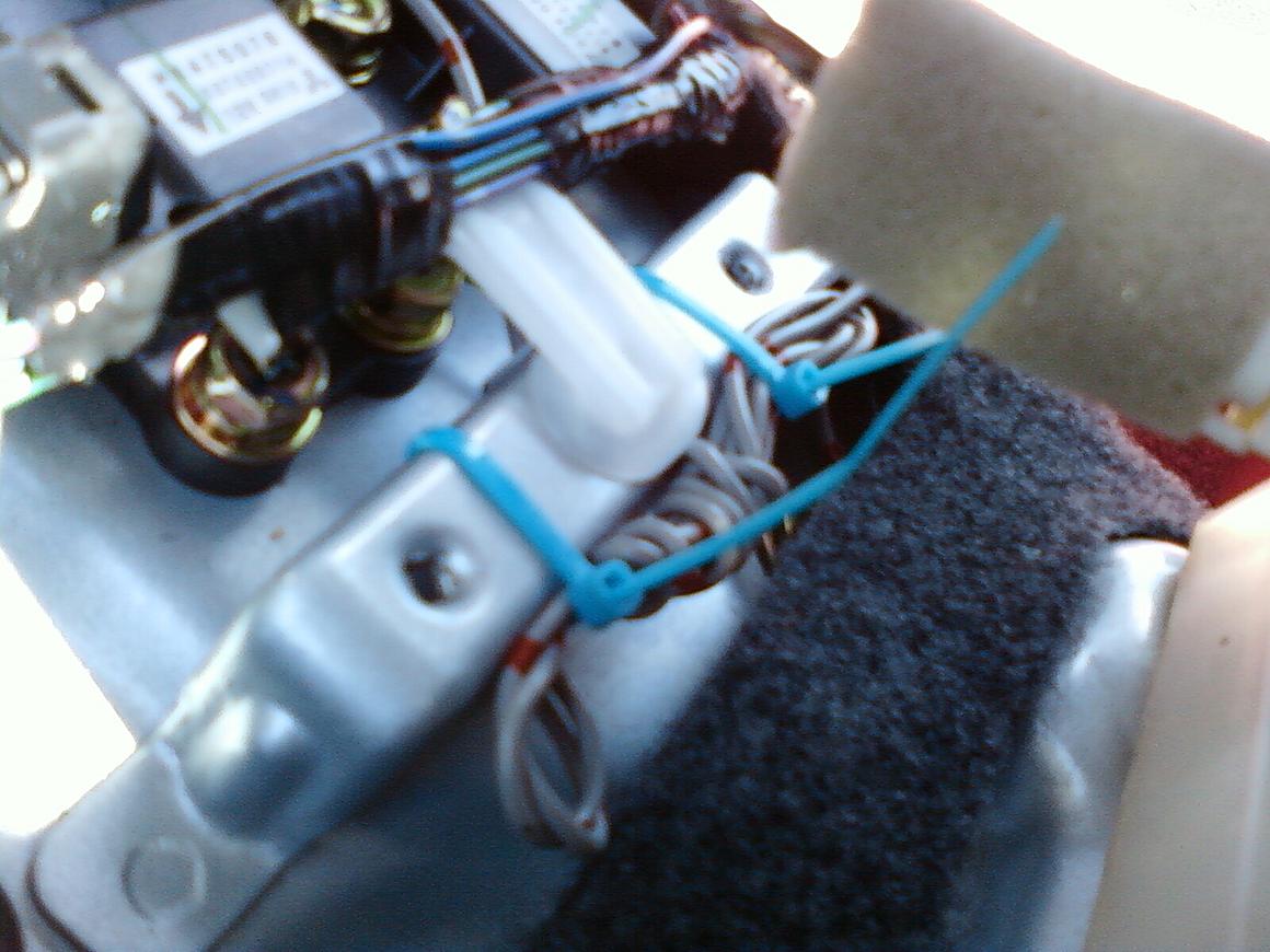

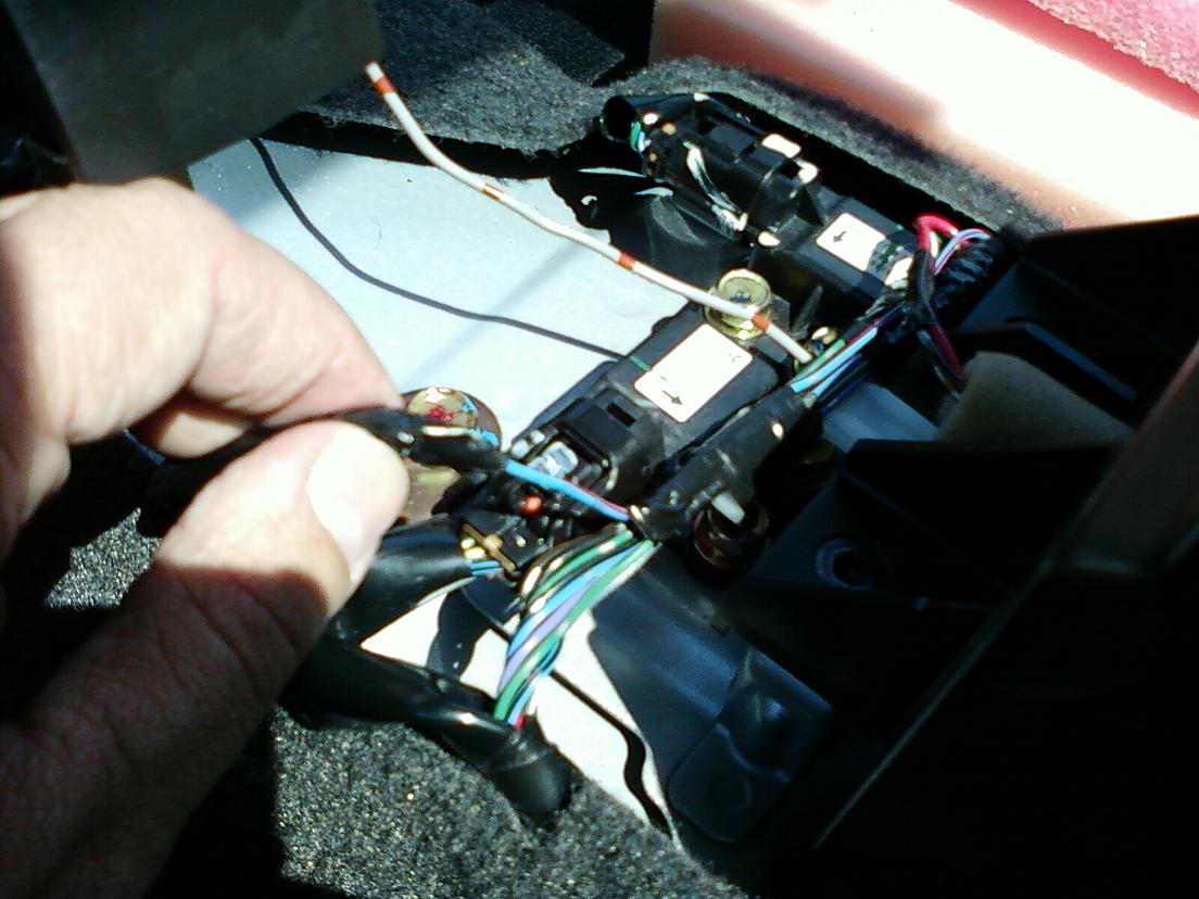

I just installed mine last week and works great. Make sure you are tapping the correct wire since there's a small bundle of wires close by besides the one for TT. See images. Hope this helps.

thanks bro and i tapped the blue one that connects to the ebrake..i mean theres only one wire so i guess its right?
