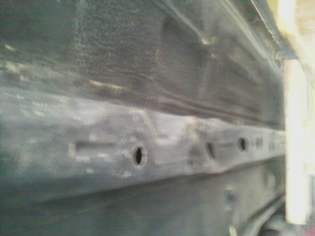

Well I brought the car down to see the automotive professor at my college. We put it on a lift, and here is what we have found.

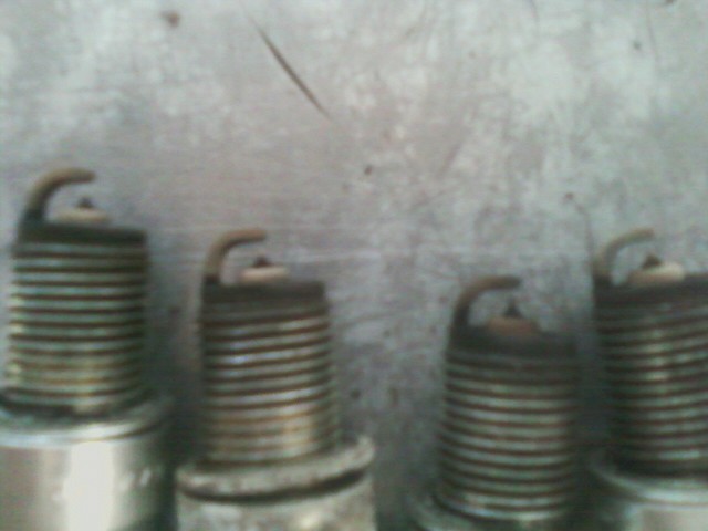

Second Picture - Spark Plugs have completely white tips, and seemingly worn electrodes.

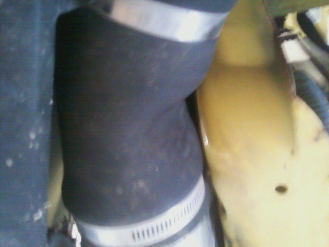

Third Picture -Intercooler coupler is smashed together, because apparently the intercooler is not mounted whatsoever escept for the pipes
Fourth Picture - Under the care frame, looks like unibody. It looks like the previous owner took it off a cliff.....

Yeah, that looks like the timing belt it came with from the factory. The picture of the plugs is too blurry to see, but if the belt is the original, the plugs probably are too. The intercooler, if not mounted correctly, can be fixed. The dents in the subframe, while not something I'd want happen to my car, are probably cosmetic.

yeah the "frame" is from someone jacking it up in the wrong spot...not a horrible issue, but the compression seems a little low.

That seems like a bad bend for it to be made by a jack

Plugs look fine, just old, replace
not sure where that IC coupler is, but it looks like it just needs to be adjusted.
Frame, like others have said, just looks like it has been used as a jack point. Not a huge deal
