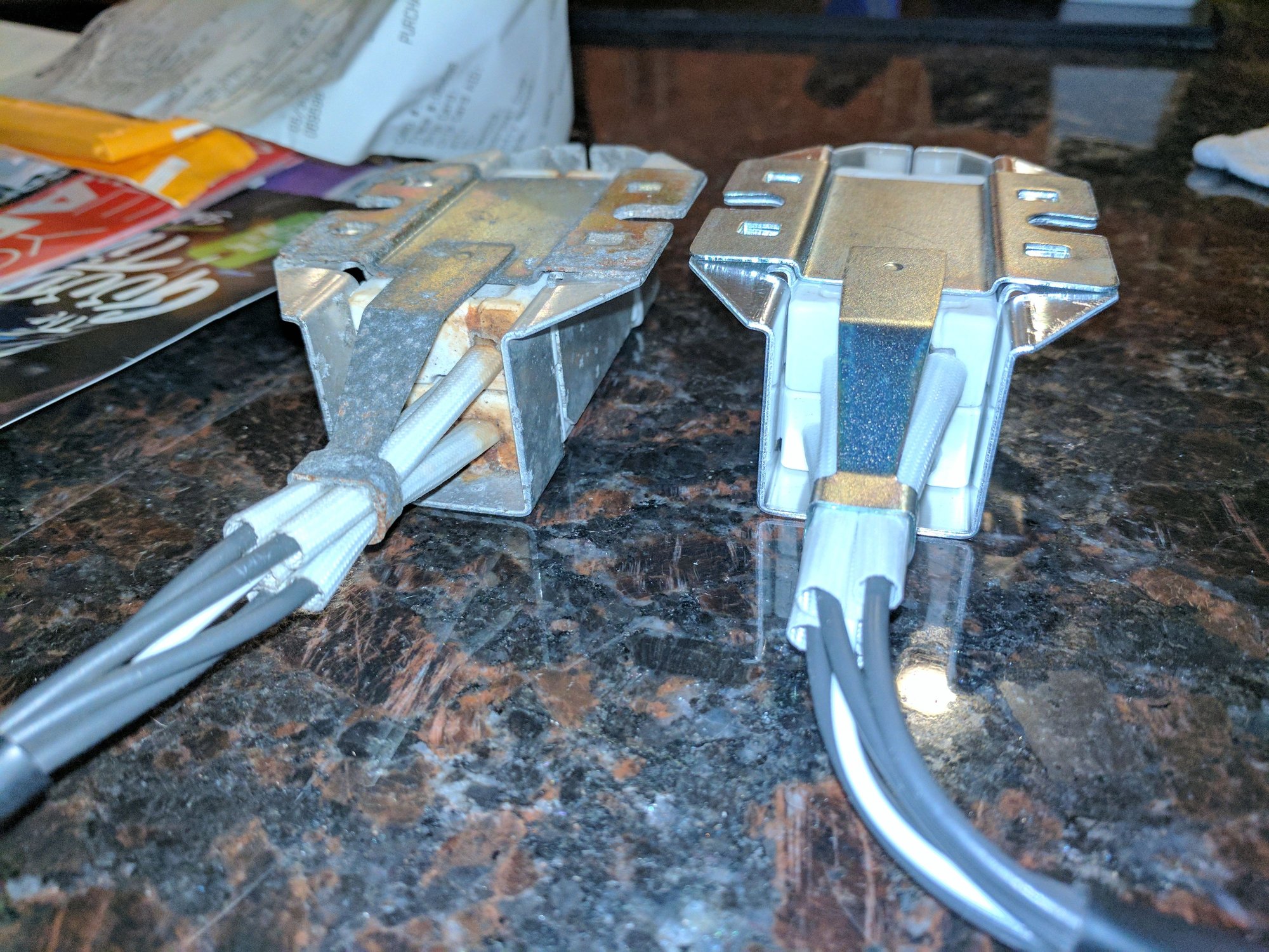

Quote: It's the injector resistor box guys. On the fire wall you'll see the metal casing plug going into the bottom with 4 white wires out the top.
I had the issue P0201. Replaced the resistor pack and problem solved
I second this. I changed this part out (part#MR561990) cost me about a hundred bucks from the dealer. Its a plug and play part and easy to install. It's located on the firewall on the passenger side next to a heat sink. (metal thing with fins) I had changed the part and been driving for a week without any problems. My old one was very corroded at the top.

some more pics to go by

I'm giving this a bump, as I suddenly ran into this issue out of no where.
I pulled my Injector Resistor Box and tested for resistance.
Pins:
3-1 : 6.5
3-4 : 6.5-6.9
3-5: 6.5-6.7
3-6: 27.80-29.03
So I am deeming this box faulty. Will be ordering another one from Mitsubishi tomorrow. Will let you guys know if this fixes the issue ( though, it should ).
Reply 0
May 31, 2017 | 06:47 PM
Update:
Replacing the Injector Resistor Box solved my problem!
